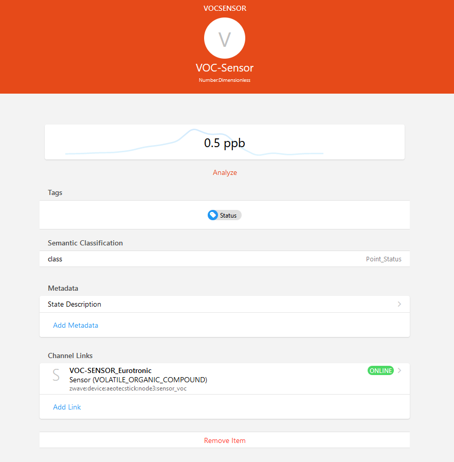

  1. Question: Well I did not think of all the options but long term I would use all of them. But first its enough to see the current value (e.g. in widget) and also store and show it it in a chart.
  2. I dont exactly know what you mean with type in this case. Would this screenshot be helpful?
  3. The binding is the (only) Z-Wave binding from Chris Jackson in Version 3.1.0

OK so it’s a Number:Dimensionless using “parts per billion” (ppb) as the units. Are you sure the value is wrong? Maybe what you really want is “parts per million trillion” (ppt). That’s the whole point of units of measurement. You don’t need to do anything really to convert between compatible units. You just need to specify which units you want to use.
So assuming you want ppt you can just specify that in the State Description metadata pattern. The field you want to set is Pattern and the docs for what goes there is Items | openHAB.
In this case all you really need to do is tell it to use ppt as the units.
%d ppt
That will change its display to ppt instead of ppt everywhere in MainUI.
However, the charting will still use ppb. There is no way around that for now.

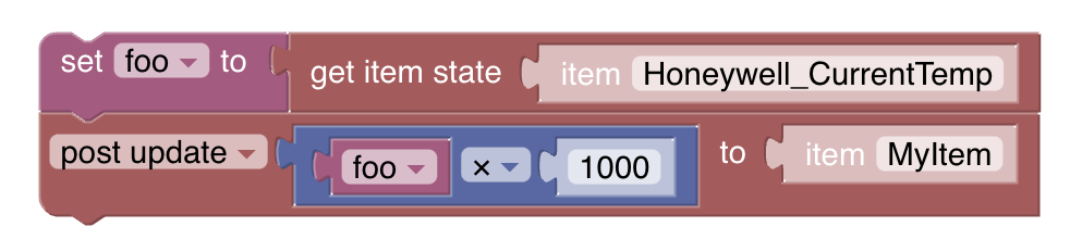

Or, because it’s just a Number Item you can use Blockly.
You couldn’t use Blockly before because the Item isn’t just a Number, it’s Number:Dimensionless.

Thanks for the Blockly, this works fine.

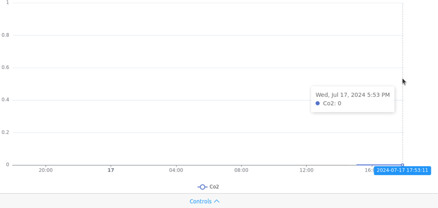

I have the Apollo AIR-1 sensor that outputs CO2 in actual concentration, like .000009, which is of course 9ppm.
My item is in an items file, and I’m not sure what state descriptions are valid. I’d like to report in ppm so graphs work better.
So, state description, or transformation?

I should have shown the current item:
Number:Dimensionless   ApolloAirSS_Co2 "Co2" (gSSMR) ["Status"] {channel="esphome:device:apollo-air-1-8808f4:co2"}
It may come out as .000009, but I want to display it in ppm, so it should display as 9.
For the semantic definitions, the chart comes out like this:
Seems like a transform to multiply by 10^6, then specify units as ppm is the way.
If there is no way to specify the unit in the Channel config then yes, you’ll want to apply a transform and define the Item unit metadata to ppm.
It there is a way to specify the unit in the Channel config then you need only set the unit to what’s being published (ppb I think) and set the unit metadata to ppm and OH will do the math for you.
Beware that the unit is not saved to the database so any values that have already been saved will not be updated so you might want to purge those values once you get things configured as you want. Or just ignore them and your charts will eventually look all right.
