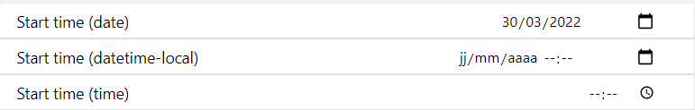

I have defined in the layout editor an oh-input-card as follow:
component: oh-input-card
  item: pool_prog1_step1_on
  type: time
  sendButton: true
slots: null
but the current time value is empty:
If I type and submit a value, it works but the new value is not shown.
If I modifiy the input card to update the date:
  type: date
  sendButton: true
slots: null
the date is correctly displayed:
Any idea how to display and edit the time like the date?

The datetime-local input type seems to give something similar to the time input type (existing date/time are not displayed):
Is there a way to ‘create’ a time item which can be displayed and edited similarly to the time type ?
Hmmm, that seems to be a problem with the display of the datetime-local value. There must be an issue with the way the input is parsing the item state. If you use the datetime-local and check your logs you should see that the item is changing state even if the input is not displaying it.
