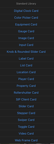

What type of widget should I use and where would I post this iFrame string? I had it working before but just can’t seem to manage it now. I’ve tried but the Web Frame Card and the Image Card.
