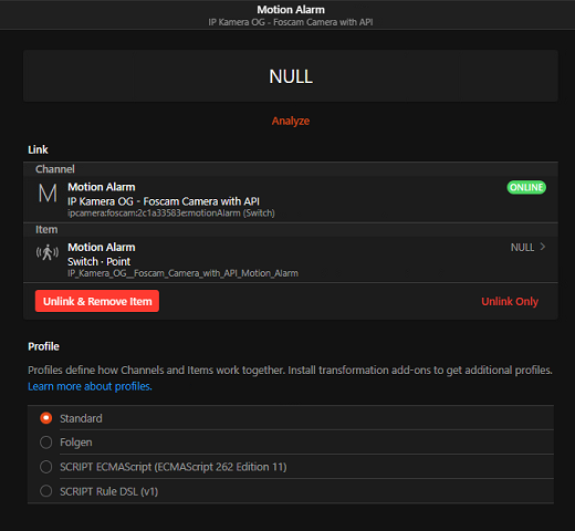

I do have a foscam integrated in OH 4.1 which is working so far. Now I would like to use the channel “Motion Alarm”. Here I added a new item but for some reasons this item is always “NULL” but I have no idea why. I can see that the motion detection of the camera settings on my mobile are activated.
Does anyone know what went wrong?
Thanks!

The camera is working and the foscam C5M has onvif support. The camera app has an onvif enable button which I set to Off and On. The result is the same and I can not see any difference in OH 4.1.
When I set manually the item “Enable Motion Alarm” (switch) to ON it goes back automatically after a few seconds. The item “Motion Alarm” remains always “NULL”.
The ONVIF port is set to 888 as indicated in the app.
Do you have an idea what wend wrong?
