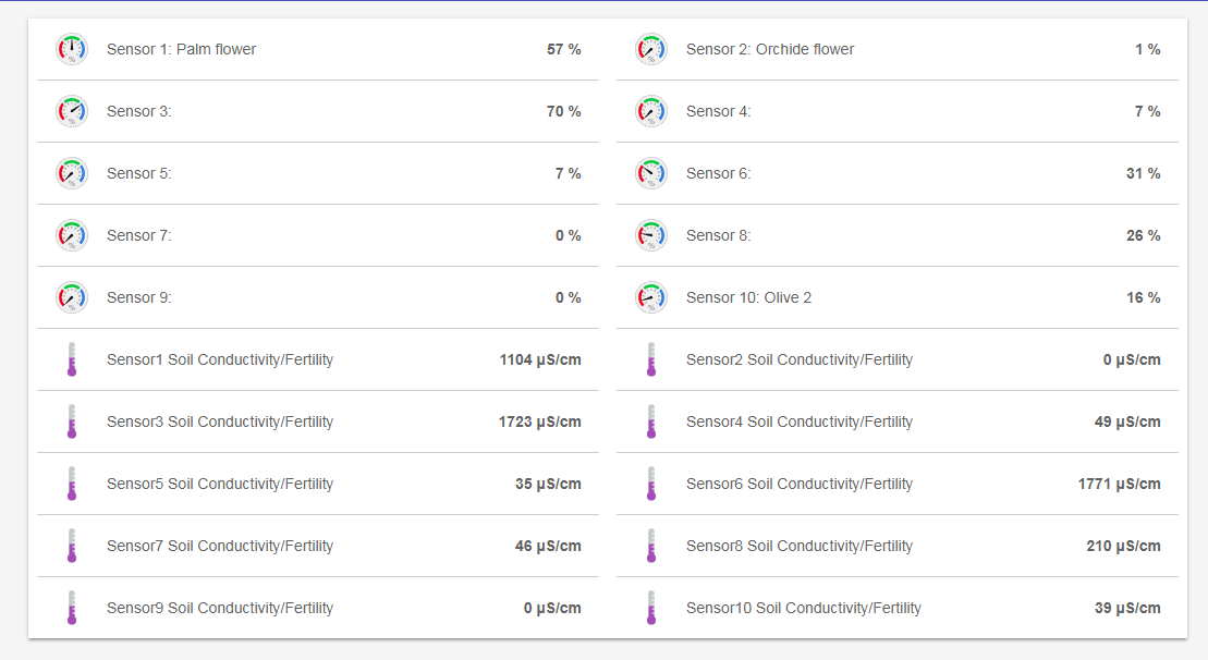

I was just wondering what happens if i set the number items to null for one item in the group and then after take average of the group, will that value just be ignored? I hope so, because I use group based average to control my heat based on the average of 12 sensors.. and if MQTT goes down while I am on holiday I still have 2 more sensors using other bindings so it should be no sleepless night then :slight_smile:
It seems like this does not get set to null, am I doing something wrong with the expire binding? No errors to be seen in VS or logs as far as I can see, sensor 9 should be null and not 0%
Are we sure expire supports setting to null? I don’t see much mention of it anywhere.
If its not supported then it is hard to make a generic rule or?
Don’t get me wrong. I don’t KNOW it isn’t supported. I’m just raising the question.

Ok, OFFLINE would work just fine, so OFFLINE is valid for all item types?
It doesn’t really make sense to send command NULL. What is the binding supposed to do with it?
Try using state=NULL.
If you don’t specify, expire will set your item to NULL or UNDEF depending on what the Item type is.
No and a valid point. I’m using stings.
For a solid one size fits all, NULL or UNDEF would be best if it works. Try Rich’s recommendation and let us know. I’m curious as well.
