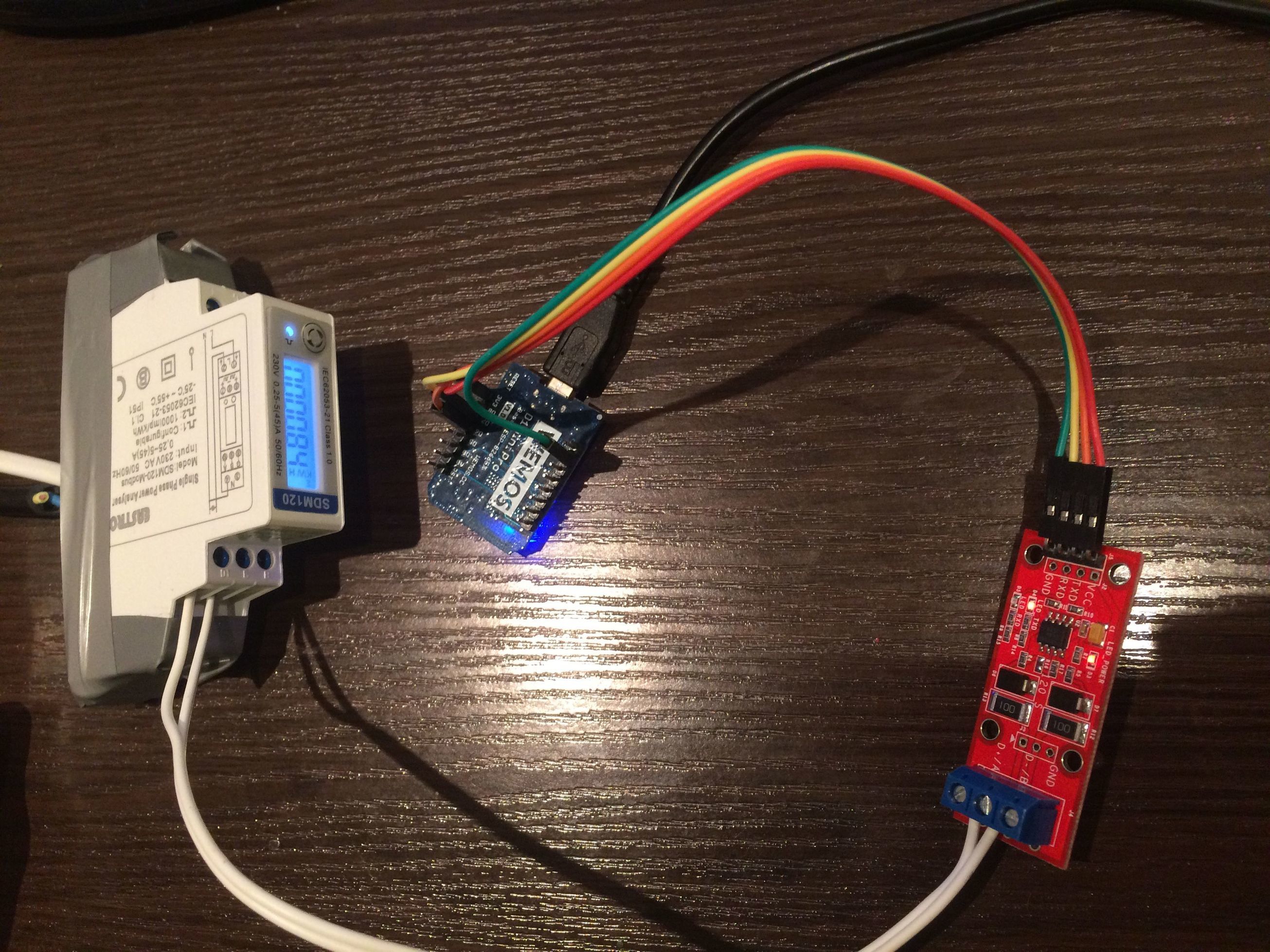

Here is cheap MODBUS Power Meter plus RS485 to TTL adapter with WiFi Wemos D1 mini and MQTT.
Can control all this parameters and publish to MQTT topic:
Voltage -Volts
Current -Amps
Active power -Watts
Apparent power -VA
Reactive power -VAr
Power factor
Frequency -Hz
Import active energy -kWh
Export active energy kWh
Import reactive energy -kvarh
Export reactive energy -kvarh
Total active energy -kWh
Total reactive energy -Kvarh

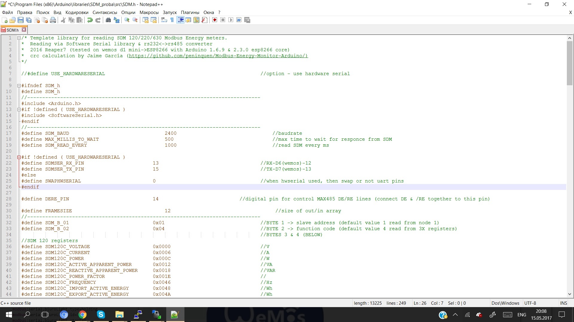

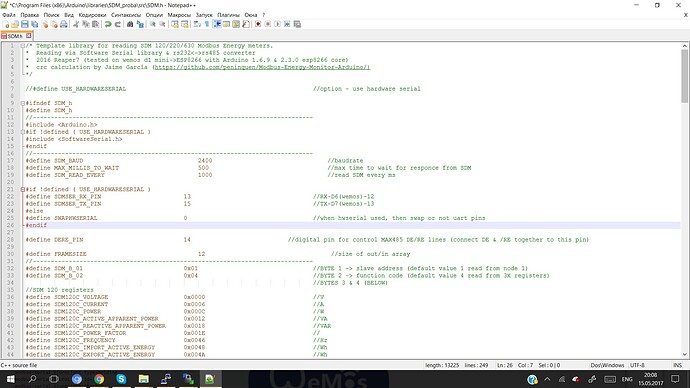

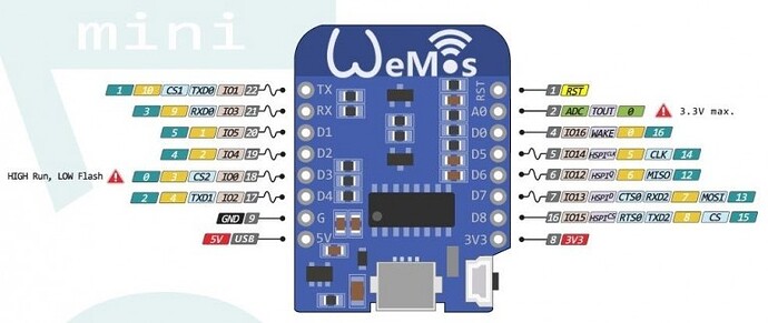

You need connect 2 wires from SDM120 to TTL adapter and 4 wires to Wemos D1 mini.
TTL VCC to Wemos 3.3
TTL TXD to Wemos D6
TTL RXD to Wemos D7
TTL GND to Wemos GND

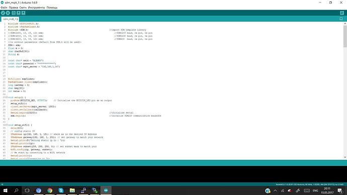

Here is sketch for Wemos were you can setup your network settings:
sdm120wifi.pdf (48.0 KB)
Rename it to .zip
Thanks to GitHub - reaper7/SDM_Energy_Meter: reading SDM72 SDM120 SDM220 SDM230 SDM630 modbus energy meters from arduino (esp8266, esp32, avr) · GitHub

assembled unit here:
unit

installed unit:
installed

Hello martiniman,
I try to repeat the transfer of data according to your sketch.
Here’s my connection using Wemos d1 mini and adapter rs-485.
TTL TXD2 to Wemos D8 - 15
TTL RXD2 to Wemos D7 - 13
TTL RE and DE together D6 -12
according
my settings

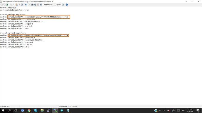

Could you please post the modbus.cfg that you have used?
[image: Встроенное изображение 6]
It would be very useful for me …
Thanks in advance
Hi. Some miss understanding, my sketch not using modbus.cfg and not using modbus binding, it post all data to mqtt topic.
But if you connect sdm120-220 directly to USB-rs485 converter - look here
