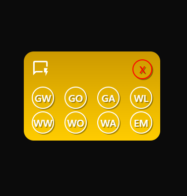

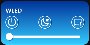

How to get a popup opened in the middle of the screen on every device?
Ideas
I want a widget with a few buttons and some stuff. One of the button should open a new window (popup, popover or page) that can easily be closed.
When the button is linked to a page with another widget for the window it isn’t smoth enough for me and I didn’t find out how to change the design (remove the HUD) of the a popup when it opens a page.
If I add another invisible “layer” on the widget which get visible by pressing the button, than it won’t be enough space to place all other things.
The Problems
So the main problem is where the popup or popover opens on different devices. I tryed it first on my PC set every thing up and openedr it on my smartphone, but the popup wasn’t even visible. The only thing you could notice is that the background gets a little bit darker or see half of the popup/popover. I looked on the Internet and found till now nothing usefull for me, even asked ChatGPT for help but some of the answers didn’t even work at all.
Questions
What should I add that the popup opens on every device in the middle of the screen? Or that the popover/popup dont’t get cut in half and is unusable? What do I miss?
Have anyone a working good looking example?
Thanks in advance for trying to help me out and excuse my bad English spelling

This is not really an easy thing. Fully responsive design can be tricky. But, that’s the point of something like the f7 library, it tries to do much of the work for you. It detects whether you are using a desktop or mobile browser, it tries to work within the screen size, and it’s default settings for it’s components should be fairly optimal for most uses.
So, the first and best answer for something like this is to get out of the way as much as possible and let the library handle it. Don’t set any size or position that you don’t have to. Don’t use an absolute value anywhere you can use a relative value.
If you have to use more specific position and sizing to achieve what you are looking for, then work within one of the responsive systems, such as flexbox or html grids, again with as few absolute values as possible.
Worst case scenario, where you just cant get something to work from those two options above, there are some objects that you can use in widget expressions to get more information and control about the environement:
In particular you can use the screen object to get information about the specific size of the viewable area you are working with, and the device object to make widget expressions that depend on whether the current viewer is a desktop or mobile browser.
I experienced the same problem, where a popup is opened but not visible on the screen. The popup is located on the far top left corner, outside your screen. If Justin’s advice is not working then try to set the position relative to where it actually is. You need to play around with the values until it appears. A few years ago I did a post about this.
Thanks @JustinG and @Oliver2 that you try to help me.
For everybody that have the same problem as me I finally figured one way out how to do that. Hopefully my English spelling is not to bad and I could help you.
What I tried
I have tried several ideas and did a lot of testing such as @JustinG said use as much relative values as possible. But the widgets didn’t looked like on the desktop and had many problems (buttons to big, to small, to much space between them, …).
After that I experimented a bit and found out that the smartphone and desktop versions had different goals. For instance on the PC, when I moved something (top: 50% left: 50%) the top left corner was moved to this position. However on the moblie phone this was not the top left but the top center.
Next thing was when I changed the size of the window (standard maximum is 630px x 630px) the window was never centered and moved every time to top and left.
Use a “display-flex” on the popup would not really work. You could adjust all items to the middle but you also see this window every time on the bottom of your screen.
The way it works
Someday I had the idea, why don’t we leave the popup window as it is and just move everything into the f7-blocks and in these I center everything.
So the first component is of course the f7-popup (background is transparent) < slots < component: f7-block (this block is complete transparrent and has a width and hight of 100% of the popup; here is every thing that moves anything in the middle with display-flex) < slots < component: f7-block (here is the widget with height width in px and the style for example background: …) < slots < Here you place anything you want in your popup.
Negative thing
The only thing I may try to figure out a solution is when you click on the backdrop (mixed with real backdrop and the f7-block) it won’t close anywhere you click because of the f7-block which you don’t really see blocks it. So you need to be far away from the center or on the smartphone you need a button which close the popup
How the widget looks
Normal view:
Normal view
Popup for presets, which was recorded with the windows snipping tool:
My Code (not perfect):

    - component: oh-button
        action: url
        actionUrl: "=props.wledUrl ? props.wledUrl : 'http://192.168.0.136'"
        style:
          height: 30px
          justify-content: left
          margin: 0px 0px 0px 0px
          width: 100px
        default:
          - component: Label
              style:
                color: var(--widget-card-text-color)
                display: flex
                font-size: var(--widget-font-size-large)
                font-weight: 600
                letter-spacing: .75px
                margin: 2px 0px 0px -9px
                text-shadow: var(--widget-text-shadow-strong)
              text: "=props.itemPrefixName ? props.itemPrefixName : 'WLED'"
    - component: f7-row
        style:
          display: flex
          height: 45px
          margin: 5px 0px 0px 0px
        default:
              action: command
              actionCommand: "=items[props.ItemShd].state === '0' ? '40' : '0'"
              actionItem: =props.ItemShd
              class:
                - display-flex
                - flex-direction-column
              outline: true
              round: true
              style:
                border-color: var(--widget-card-text-color)
                border-width: 2px
                box-shadow: var(--widget-text-shadow-strong)
                height: 45px
                width: 45px
              default:
                - component: oh-icon
                    height: 35px
                    icon: "=props.itemPrefixIconShd ? props.itemPrefixIconShd : 'iconify:ion:power'"
                    style:
                      color: "=items[props.ItemShd].state > 0 ? 'var(--widget-card-text-ONcolor)' :
                        'var(--widget-card-text-color)'"
                      display: flex
              action: command
              actionCommand: TOGGLE
              actionItem: =(props.ItemSleepS)
              class:
                - display-flex
              outline: true
              round: true
              style:
                border-width: 2px
                height: 45px
                width: 45px
              default:
                    height: 35px
                    icon: "=props.itemPrefixIconSleepS ? props.itemPrefixIconSleepS :
                      'iconify:icon-park-outline:sleep'"
                    style:
                      color: "=items[props.ItemSleepS].state === 'ON' ?
                      display: flex
              action: popup
              class:
                - display-flex
              outline: true
              popupOpen: .presetsLED
              round: true
              style:
                border-width: 2px
                height: 45px
                width: 45px
              default:
                    height: 30px
                    icon: "=props.itemPrefixIconPresetsPop ? props.itemPrefixIconPresetsPop :
                      'iconify:ic:outline-quickreply'"
          - component: f7-popup # here starts the popup
              backdrop: true
              class:
                - presetsLED
              closeByBackdropClick: true
              closeByOutsideClick: true
              closeOnEscape: true
              style:
                background: rgba(0, 0, 0, 0)
                box-shadow: none
              default:
                - component: f7-block # the block which is as big as the popup and centers everything
                    class:
                      - display-flex
                    style:
                      justify-content: center
                      align-items: center
                      height: 100%
                      width: 100%
                    default:
                      - component: f7-block # Here is the block for the look of the popup widget
                          class:
                            - padding
                          style:
                            --widget-card-ONcolor: "=(!props.TextONcolor) ? '44,228,44' : props.TextONcolor"
                            --widget-card-border-radius: 20px
                            --widget-card-color: "=(!props.TextcolorPopup) ? '255,255,255' :
                              props.TextcolorPopup"
                            --widget-card-text-ONcolor: rgba(var(--widget-card-ONcolor),1)
                            --widget-card-text-color: rgba(var(--widget-card-color),1)
                            --widget-card-text-shadow-color: "=(!props.TextIconShadowPopup) ? '0,0,0' :
                              props.TextIconShadowPopup"
                            --widget-font-size-large: 20px
                            --widget-font-size-normal: 16px
                            --widget-text-shadow-strong: 2px 2px rgba(var(--widget-card-text-shadow-color),.35)
                            background: "=props.itemPrefixBackgroundcolourPopup ?
                              props.itemPrefixBackgroundcolourPopup : 'linear-gradient(to
                              bottom, #cc9900 0%, #ffcc00 100%'"
                            targetEl: '[ref="widgetRef"]'
                            #padding: 10px 10px 10px 10px
                            height: 180px
                            width: 275px
                            border-radius: var(--widget-card-border-radius)
                        slots: # here starts the things you want to be in the popup widget
                          default:
                            - component: f7-row
                                default:
                                      height: 35px
                                      icon: "=props.itemPrefixIcon2row3left ? props.itemPrefixIcon2row3left :
                                      style:
                                        align-items: center
                                      action: popupClose
                                      class:
                                        - display-flex
                                      outline: true
                                      popupClose: .presetsLED
                                      round: true
                                      style:
                                        border-color: red
                                        border-width: 2px
                                        height: 40px
                                        width: 40px
                                      default:
                                        - component: Label
                                            style:
                                              color: red
                                            text: X
