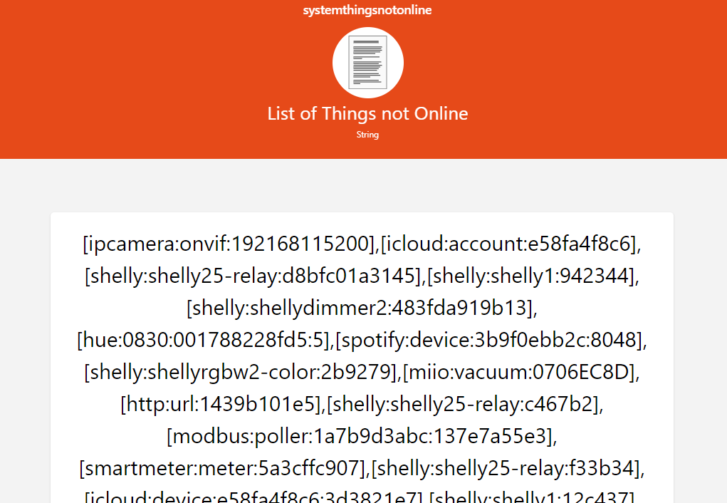

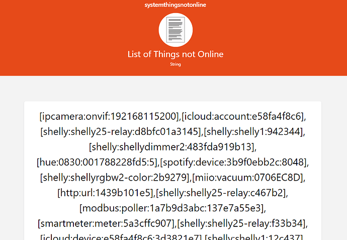

… and this is how my systemthingsnotonline item looks like:

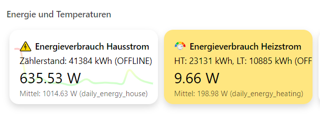

… and here is the widget that I use to show my energy consumption, smart meter reading and trend line. Besides using my OFFLINE item (s. above), I am also comparing the latest activity with an NTP read to detect if my energy updates are running late:

This is how my widgets look like:
