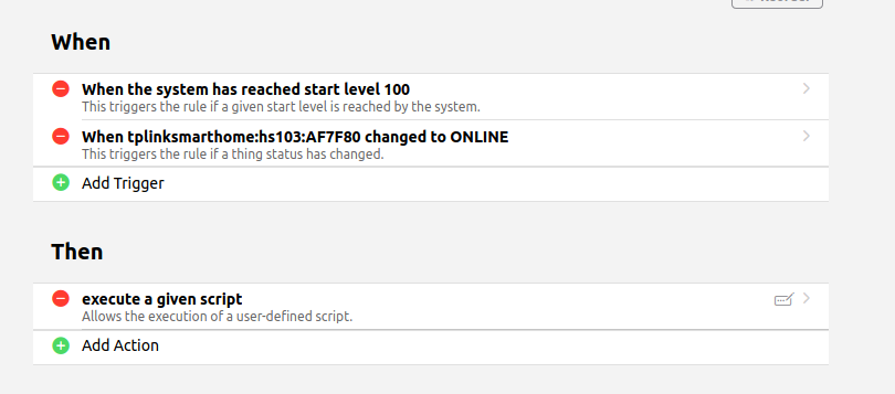

I want a rule/script that ensures some lights are ON or OFF after openHab restarts or after the lights’ smart switch comes back ONLINE. My issues have to do with using the Astro binding add-on programmatically from Javascript. Alas, the only way I have figured out how to do this is to “Create Points from Thing” using the Astro’s “Local Sun” thing’s Sunrise “Start Time” and Sunset “End Time”.

It is not at all clear what this rule is for. It looks like it’s supposed to trigger when OH restarts or it gets some command from a TP Link. As far as I can tell it spends a whole lot of effort to see if it’s between sunRise and sunSet and turns on a switch accordingly. I guess I’d have the following comments on how the rule could be made better:
You seem to go out of your way to convert the Item names to variables. I’m sure you are a programmer at least a little bit and it feels icky to hard code stuff like that. All I can say is all your rules will be much more complicated and much longer if you continue to do that as opposed to just accepting the fact that the stuff your rule needs to interact with and get information from is going to be Items and you’ll have to reference those Items by name. Often the name is hard coded, other times they are constructed based on other information the rule knows. Also note that you cannot change the name of an Item once it’s created. To change the name you have to delete the Item and recreate it with a new name. In short, changing an Item’s name is a big deal. So it is unlikely that these Items will be changing name much anyway and when they do, you have a lot of checking all over OH to make sure it changes everywhere. IMHO adding checks to your rule in case the Item changes it’s name is simply not worth the effort, especially since a reasonable error will be thrown if you try to access an Item that doesn’t exist anyway.
