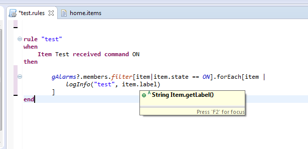

How to get item labeltext from range operator?
If i use code below, i got error:
java.lang.RuntimeException: The name '<XFeatureCallImplCustom>.label' cannot be resolved to an item or type.
gAlarm?.members.filter[item|item.state == ON].forEach[item |

Designer says for item.
- String org.eclipse.smarthome.core.items.Item.getLabel()
But this generates error, why?

I see no error in that screenshot.
I just did a quick Designer test (did not run) and calling item.label does not generate an error for me in Designer.

Please look at my first post, I posted error there.

Hmmm. I actually ran my test and it worked. I’m not sure what could be wrong. What build are you running?

I use OH 1.8.3 and preparing my rules to OH2.

Ah, that’s the problem. You can’t get the label in 1.8, only 2.0.
