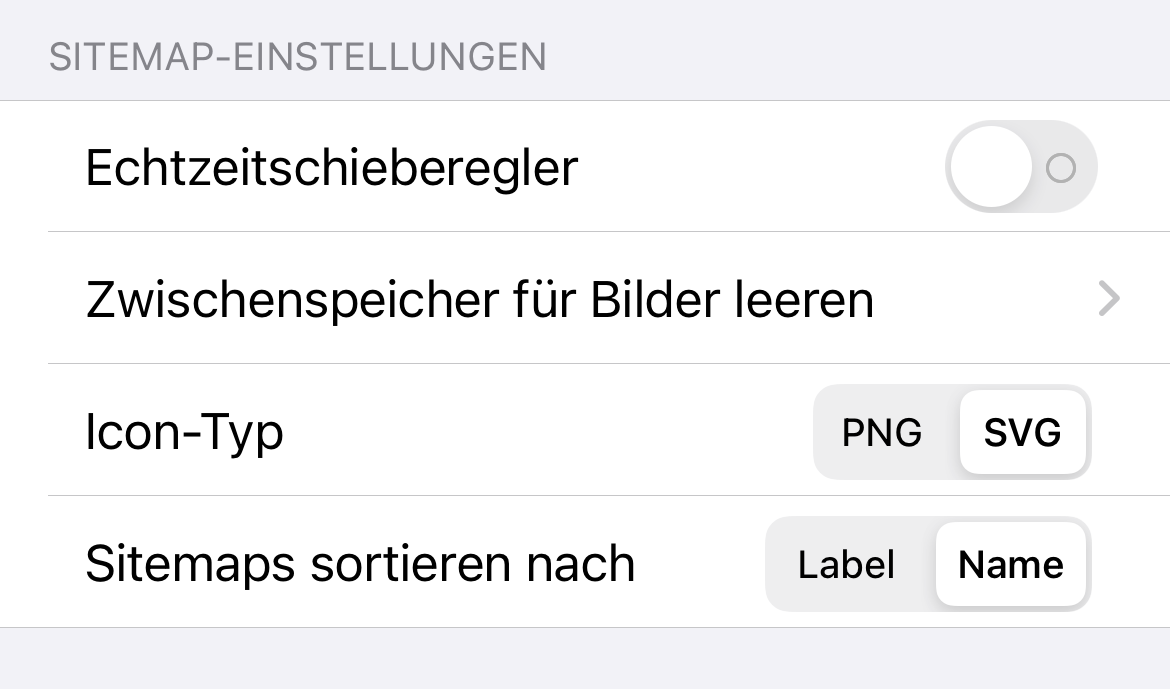

here is the „global“ setting
Vielen Dank für die Antwort - thanks for the reply @HaKuNa
This setting only applies to the app and unfortunately doesn’t have an equivalent that I can find for viewing the sitemap on the webbrowser.
