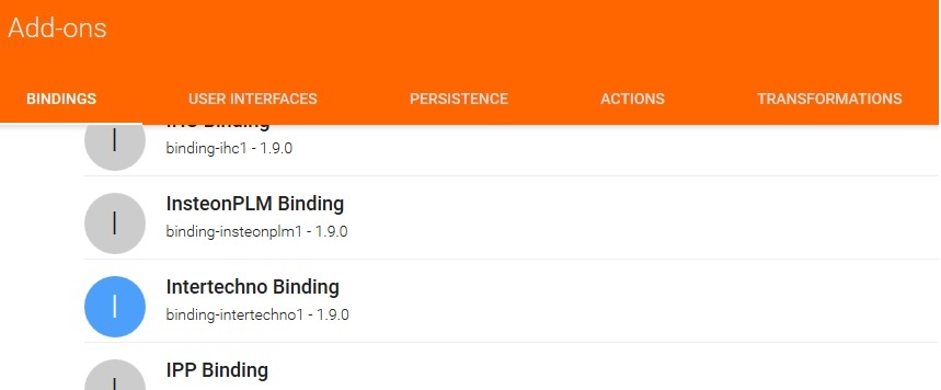

High, just installed the snapshot version of OH2 (#887). I’m missing the 1.9.0 Binding versions (especially Intertechno). Using the RC version they show up under Add-ons - Bindings, but not in the snapshot version.

I’m using the OH2 release version on my live system. In this version they are showing!
