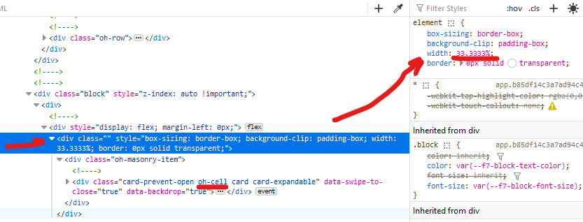

Are there any more details available if you inspect the page? Is there an oh-cell rendered or an empty parent-container?
Seems it requires some additional code support to render the outer container only if there is a visible component inside. It works with oh-grid-col when using visibleTo inside the column configuration:

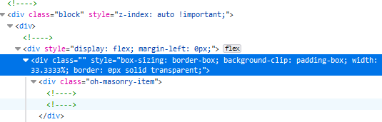

This seems to do the same as the visibleTo property. It hides the cell but the outer element is still present and consumes the width:
This is how it looks if visible is false or visibleTo does not match:

When the oh-masonry uses the default settings it’s using the vue masonry library and you can see that this winds up wrapping each oh-masonry-item in an additional div container:
<div style="display: flex; margin-left: 0px;">
  <div class="" style="box-sizing: border-box; background-clip: padding-box; width: 25%; border: 0px solid transparent;">
    <div class="oh-masonry-item">
Those extra containers are the masonry columns (which means they are fixed-width based on the number of columns in the masonry) and they don’t go away even if there’s nothing rendered in the oh-masonry-item container. As far as the vue masonry library is concerned, that’s a feature not a bug.
