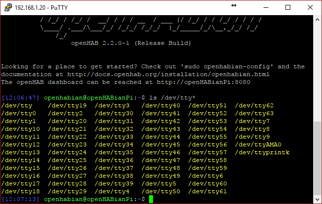

Hey guys, I have the Z-Stick on my hands but i´m way far from knowing WTH I should do with it, any help?
I connected the device and this is the list that is showing:
thanks a lot
I got the same problem.
I’m new to internet things, I bought a raspberry pi3 a Z-Stick Gen 5, and I install openHABian because it seems to be the best tool for managing internet things.
I got exactly the same screen above with /dev/ttyAMA0 but when I go to Paper UI interface / configuration / things and in Z-Wave Serial Controler in port configuration / Serial Port if I type /dev/ttyAMA0 when I quit I receive the message : : OFFLINE - COMMUNICATION_ERROR Serial Error: Port /dev/ttyACMO does not exist
