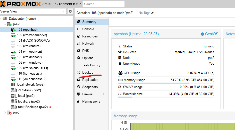

@JustinG , @rlkoshak how to you backup your openHAB installation? Do you backup the LXC container/VM at Proxmox level or do you use any other tool inside the visualized Linux LXC/VM ?
I do this:
As well as use the proxmox backup program which does the proxmox VM to another computer.
@DrRSatzteil have you had to upgrade you openHAB installation ? if yes how did you do it since the Helper Scripts only create a fresh installation ?

I use the proxmox backup systems. Nightly backups go to a drive on the proxmox box itself, keeping the three most recent. Weekly backups are stored on my synology and every couple of weeks the synology is backed up to my encrypted iDrive. If I’m making significant changes to some OH configuration, I also check those out to a git repo before and usually after.
Before I moved to proxmox, I used borg for most of my backup and I’m honestly considering setting that back up again. The proxmox backups are convenient and easy, but they full backups and not sequential so they take up a little more space than I’d like. This is really only an issue because of the occasional online backup to iDrive and how long it can take. I’ll probably get back to working to optimize this a little more in the future, but I’ve got enough other projects at the moment that it’s not a huge priority.
