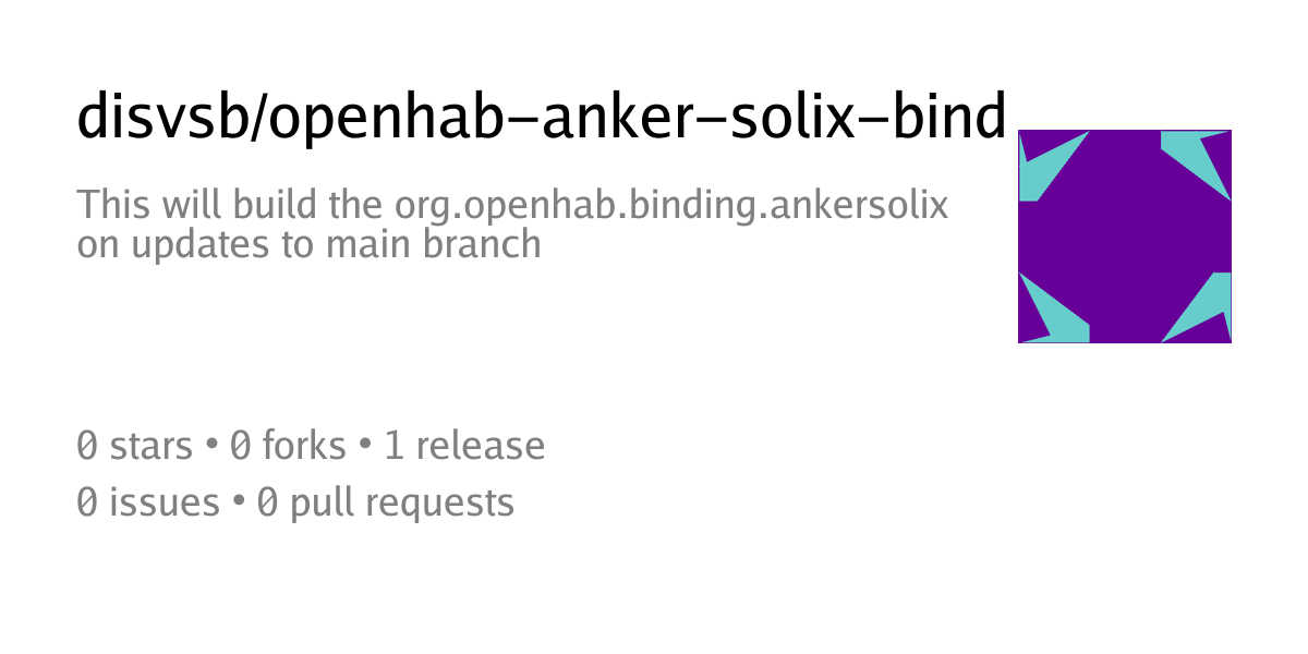

As I’m planning to get a Solix3 myself and find this integration interesting, I’ve set up a build pipeline that generates the JAR file and publishes it to my Forgejo instance. You can find it here:
The pipeline is kept fairly simple and creates a new snapshot release as soon as a commit is made to the main branch. If I have time, I might add the ability to build releases using tags.
