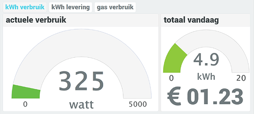

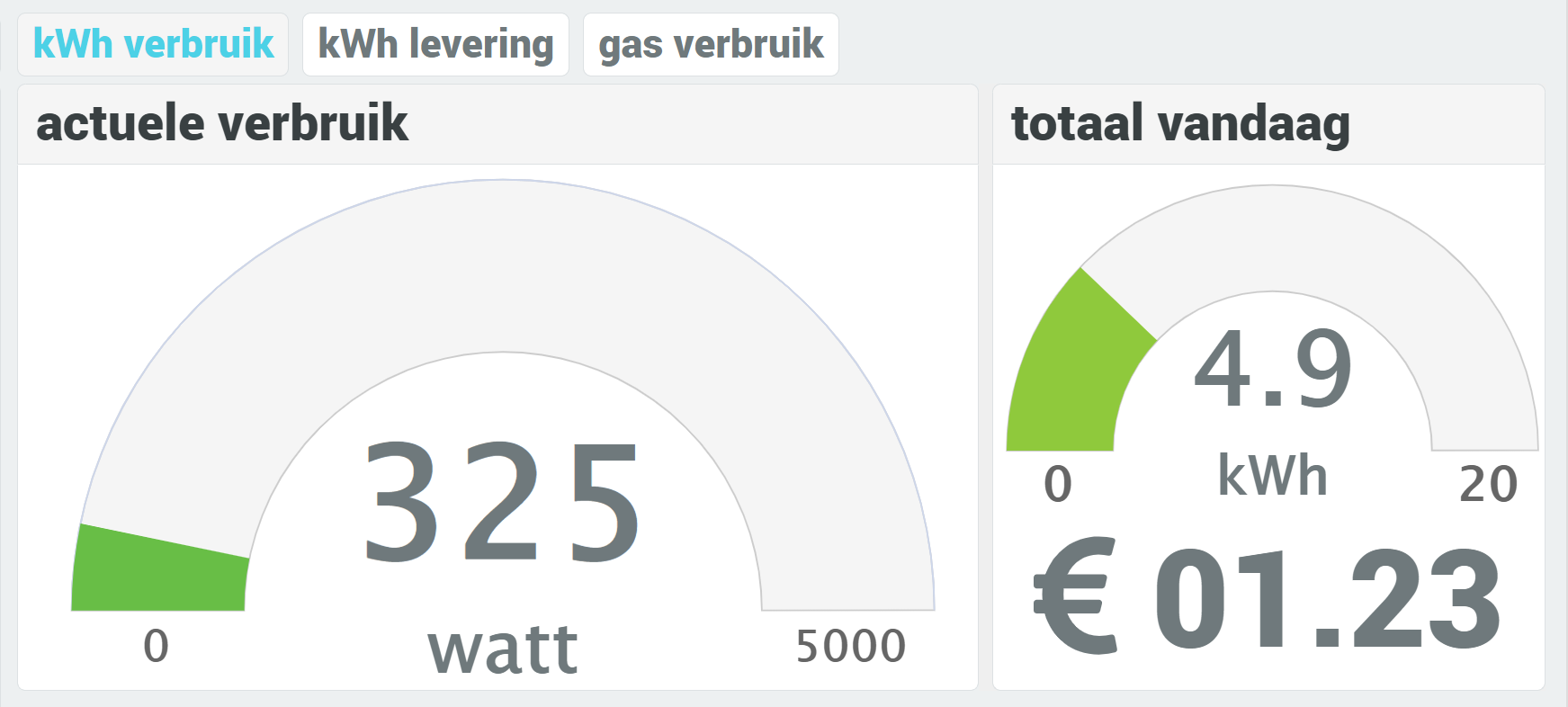

And want to create a widget for Main UI similar to the native UI of “P1 Monitor” UI
Example “P1 Monitor” UI
p1
