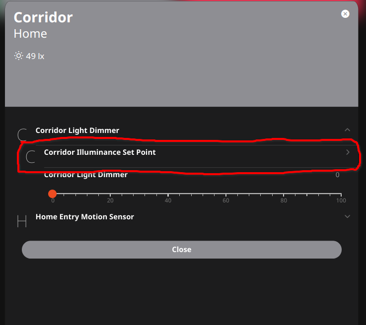

I’m trying to create an item to set a desired value for illuminance.
How can I make it editable in the model?

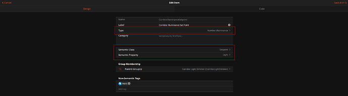

Item’s code:
label: Corridor Illuminance Set Point
type: Number:Illuminance
category: ""
groupNames:
  - CorridorLightDimmer
groupType: None
function: null
tags:
  - Light
  - Setpoint
  - Point
This item is not editable in the model. All I can do is to see its current value and a graph with historical values.

I’ve tried to search OpenHAB documentation (here and here in particular, but not limited to these pages) about “categories” and their connections with a “semantic model”, didn’t found anything.
As far as I understand, an item’s “type”, “semantic class” and “semantic property” are what is important for the semantic model.
They were from the beginning and the item in question is not editable, nonetheless.

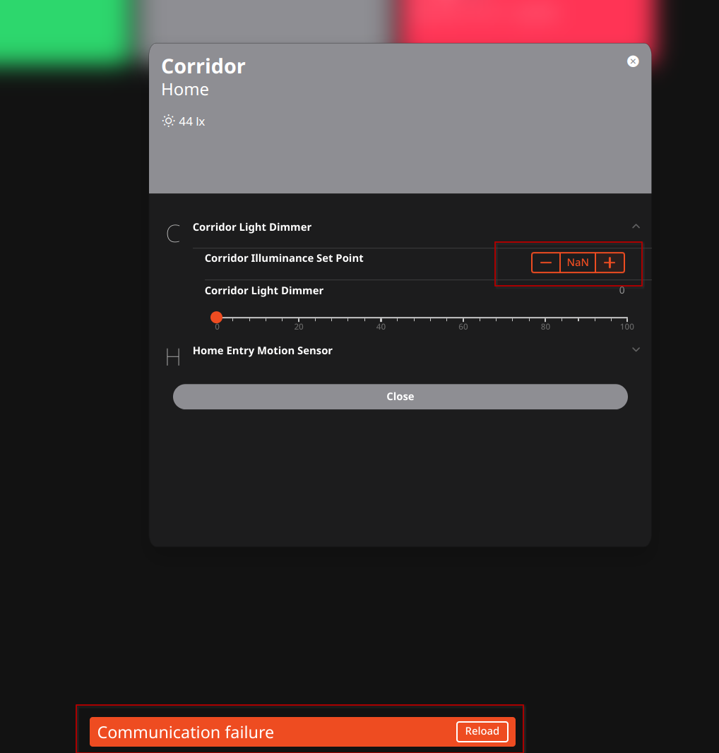

Stepper item changed an appearance of the widget, but it errors on plus or minus button pressing.
