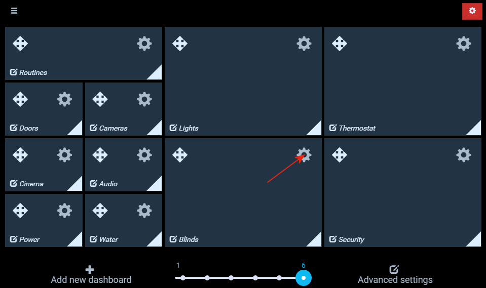

I’ve just installed the 2.4 snapshot version, but cannot see the settings dialogue that’s in your image. how do I et to it?
It should be there.
That page, which I have studied carefully, never mentions the settings dialogue shown in this post: https://community.openhab.org/t/how-to-make-dashboard-responsive/33268/8?u=evansnp.
What I need is the ‘Allow mobile mode’, which I cannot find anywhere.
Configure the tiles and the dashboards themselves with the gears icons in the top-right corner of each tile;
Thanks Yannick, perfect!
 that’s the one place that I didn’t look!
