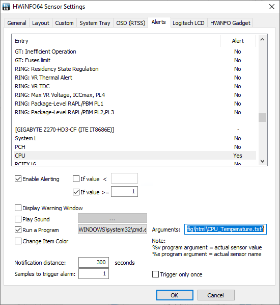

Within HWinfo, browse the sensors. Find the sensor you wish to “record”/display in openHAB – assuming here this is CPU Temp (I’ve opted for the CPU temp being read via the Motherboard, another option would have been CPU Package – an average combination of all cores, read from the CPU itself). Right click on it, and select Alert Settings.
In “Alert Settings”, select;
  • Enable alerting, if value >= 1
  • Run a program (defaults to cmd.exe)
  • Add argument – /c del “\fqdn\path\to\openhab2\config\html\CPU_Temperature.txt” /f /s /q && echo %v >> “\fqdn\path\to\openhab2\config\html\CPU_Temperature.txt”
  • Define your own time/frequency (mine is set to 5 minutes)
The argument here deletes the previously written “CPU_Temperature.txt” and then echo’s the current CPU temp into “CPU_Temperature.txt”… Why? Honest truth, I couldn’t find how to have openHAB read the last line/latest CPU temp from an array. So I just decided to delete the previous “log” and write again. The result is a text file with one entry, thus only one entry for openHAB to read.
