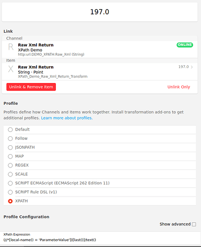

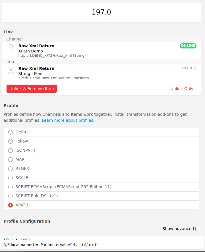

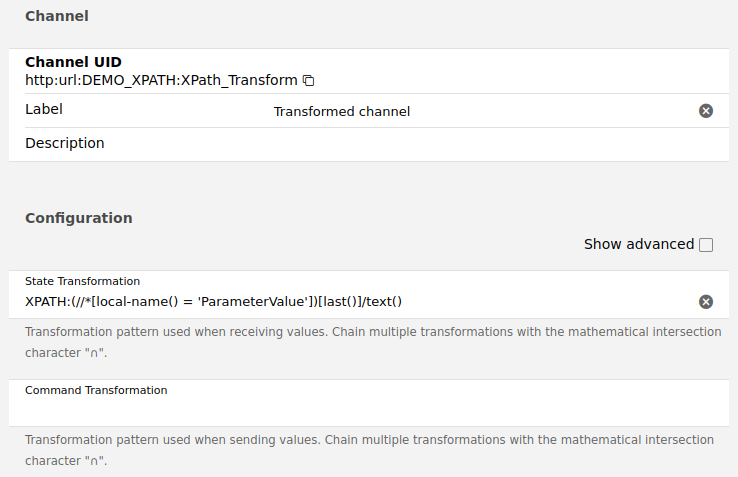

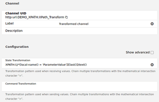

OK, I’ve done some testing. The problem is that this xml uses nodes with the full namespace:local-name syntax, and the colon inbetween the namespace and local node name is breaking either the UI’s handling of the string before passing it to the transform or the transform, itself. I’m not sure yet which it is. I suspect the problem is with the actual transform because the issue happens both with the Profile without the "XPATH:transform...." and the channel definition with it.
I’ve test this alternate XPath that bypasses the namespace part of the node names and can verify that it works:
(//*[local-name() = 'ParameterValue'])[last()]/text()
Profile version:
Http Channel version:
