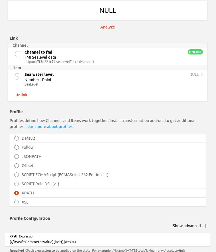

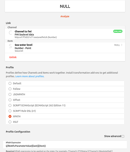

Tried the http binding method, but got stuck:
There are a couple of things you can always do to troubleshoot the html binding.
  1. Check you logs and make sure the binding isn’t throwing any obvious errors.
  2. Create a basic channel for a string item with no transform on it. Make sure that the string item gets populated by the page content that you expect. If not then you know the problem is the configuration of the binding.
  3. If you can show that the binding is collecting the full returned content into a string item then there’s something wrong with the transform and you can test out the xpath statement with any online xpath tool such as Free Online XPath Tester / Evaluator - FreeFormatter.com
This i what is logged:
</wfs:FeatureCollection>
' with function '(XPATH://BsWfs:ParameterValue)[last()]/text()' and format '%s'
2023-08-28 14:56:16.338 [WARN ] [org.eclipse.jetty.http.HttpParser   ] - URI is too large >8192
2023-08-28 14:56:16.353 [WARN ] [org.eclipse.jetty.http.HttpParser   ] - URI is too large >8192
2023-08-28 14:56:46.200 [WARN ] [.profiles.XPathTransformationProfile] - Could not transform state '<?xml version="1.0" encoding="UTF-8"?>
<wfs:FeatureCollection
This works. The item gets populated with the XML file I am looking for.
How to apply the XPATH is still a mystery…

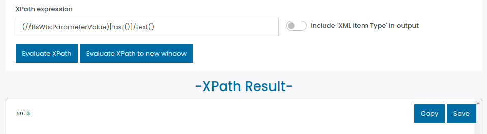

This is what the xpath tool above shows as output:
Text='119.0'
Execept for the “Text=” this is what I was looking for.

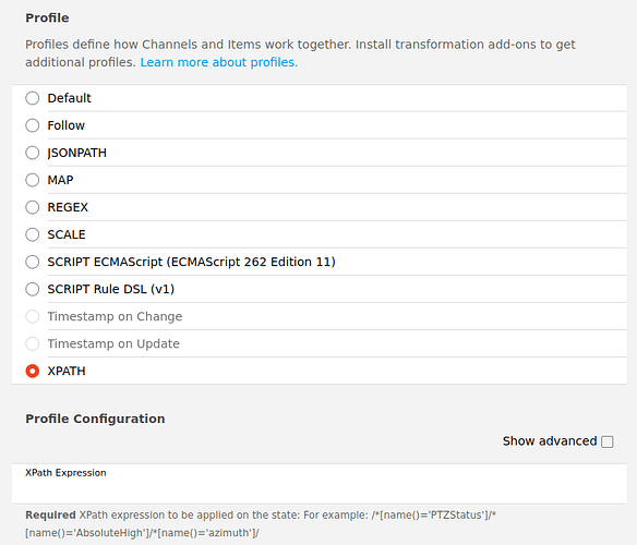

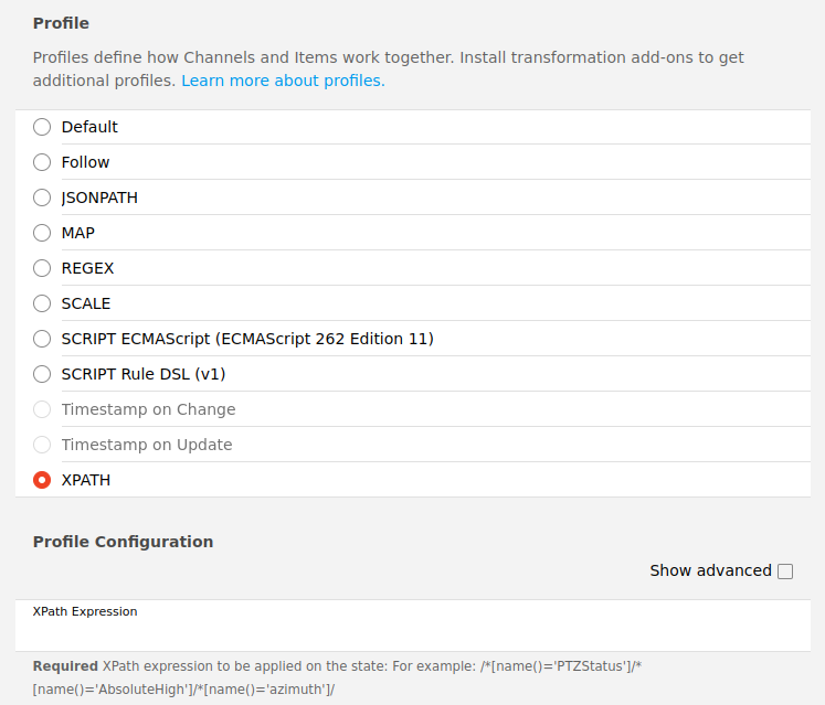

Where should the XPATH be applied? In the channel or item? If so, how?
If Telegram has a place to define a transformation on the Channel, do it there. If not, apply the XPath transform on a Profile on the Link between the Channel and the Item. Or create a Rule and use the transform action.
With the Http binding, that depends entirely on your use case. If you think you are only ever gong to need this one bit of information then, you can apply it to the channel. When you define the channel with the UI, there’s a place right in the wizard to apply the transform:
So, you would make it a number channel and add the XPath transform definition to the channel.
On the other hand if you think that you might want to extra other information someday form this same xml then you should leave the channel as a String Channel, and link a Number Item to it using a profile to apply the transformation:
I have situations where I do both of these things.
That looks correct to me. The text= is just output formatting of the xpath tester. If you unselect the item type option on the page, you will see that the actual return value is just the number:
Check your transform definition, I think the problem is probably the position of that first ( which, if you’re putting it in the channel transform slot should be after the XPATH:
XPATH:(//BsWfs:ParameterValue)[last()]/text()
