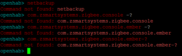

Thanks for answering that fast!
Unfortunately I get a “Command not found” error.
As per documentation the -dongle and -port options are always required. I guess “–help” should work without those inputs.
What version of OH are you running? Do you actually have the command line bundles installed? (edit - the fact that the command is highlighted in red would suggest not).
The zigbee command line bundles should be installed by default, along with the binding, in recent versions of OH (I forget how recent, but maybe the past year or so). If you are running an old version, then this might not be installed and you would need to manage this manually by downloading the bundles and adding them to the addons folder.
