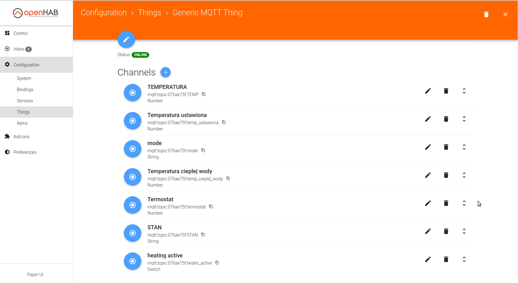

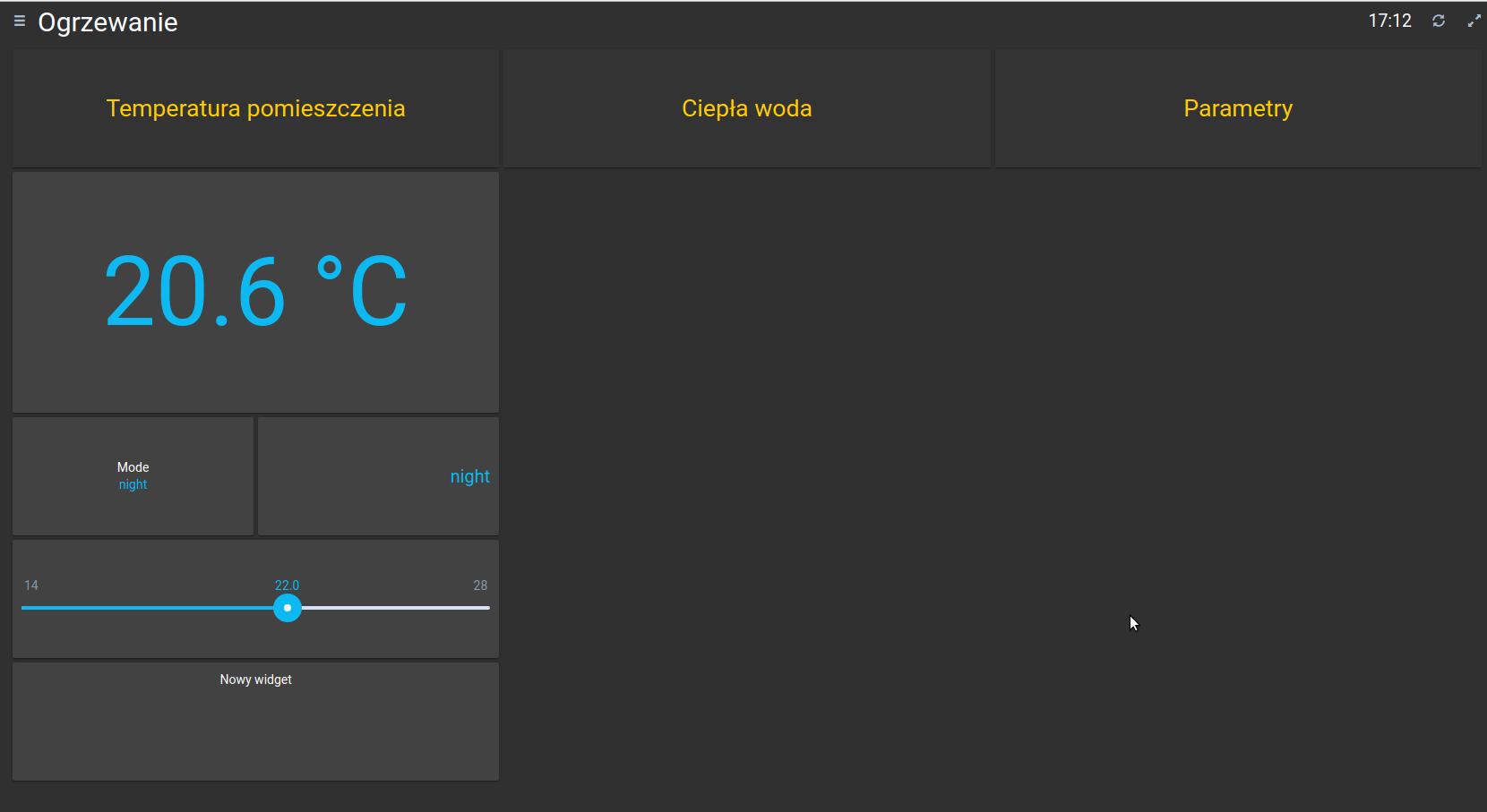

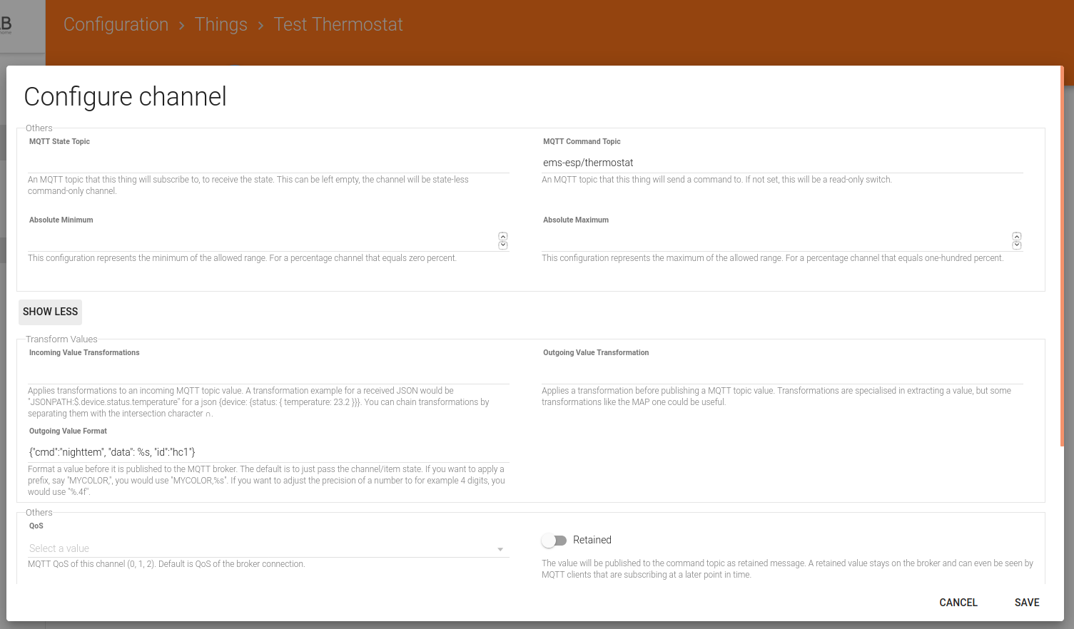

so i took screenshots, maybe easier
this my panel and slider connected to thermostat channel
i want the channel to send mqtt format to other davice when slider change this format command
{"cmd":"nighttem", "data": %d, "id":"hc1"} with the data from slider value

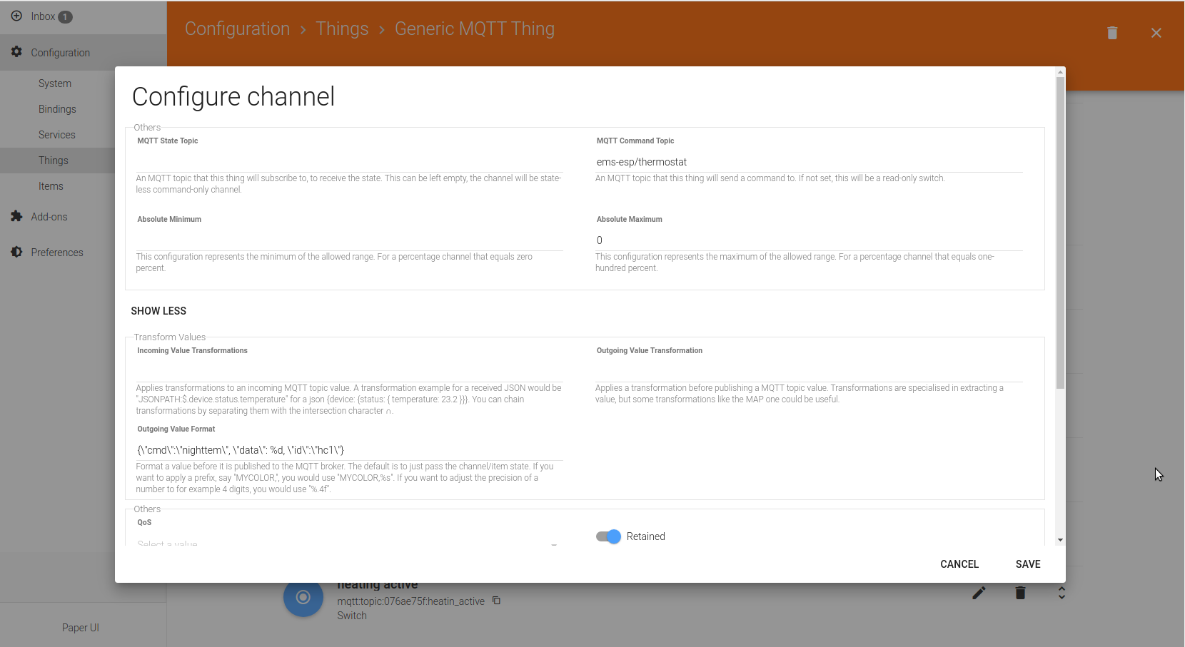

and i put the json format here
sorry for my bad english, i native language is polish
We’re going to have to assume that your openHAB Item is correctly linked to your Thing Channel, and to your HABPanel slider widget.
If so, the following should work:
{"cmd":"nighttem", "data": %s, "id":"hc1"}
I did recommend trying with %s and removing the escape slashes - did you try that already?

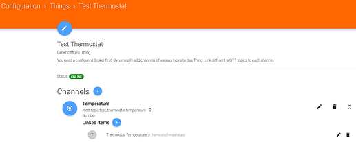

In PaperUI the Channel configuration looks as below:

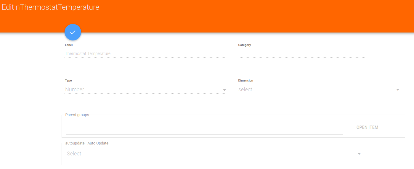

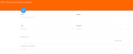

In PaperUI, the Item configuration looks like below:
The Item is linked to the temperature Channel created above. This is shown in PaperUI as below:

HABPanel
In HABPanel, I added a Slider widget, and configured as follows:
Which ends up looking like:
And also seems to work.
In the pic you posted of the Generic MQTT Thing Configure channel
Set MIN to Zero and MAX to 100
