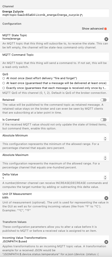

In OH3 i set MQTT state topic: home/energa
and incoming value transformations to: JSONPATH:$.used
but even after this my item has “-” value…

You have a typo in the transformation. You need a period “.” between $ and “used”
$.used
Yes, You are right, but this is only because I tried everything. But even with or without “.” nothing changes..
Note that small thing configuration edits may not get picked up immediately. When you have edited to your best guess, restart the binding or OH.

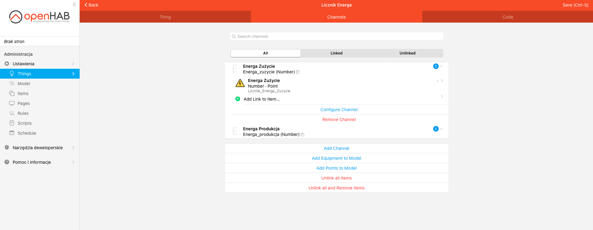

here is Thing code:
UID: mqtt:topic:5aa2c65a64:Licznik_energa
label: Licznik Energa
thingTypeUID: mqtt:topic
configuration: {}
bridgeUID: mqtt:broker:5aa2c65a64
channels:
  - id: Energa_zuzycie
    channelTypeUID: mqtt:number
    label: Energa Zużycie
    description: ""
    configuration:
      stateTopic: home/energa
      transformationPattern: JSONPATH:$.used
      unit: kWh
  - id: Energa_produkcja
    label: Energa Produkcja
    description: ""
    configuration:
      unit: kWh
      formatBeforePublish: "%.4f"
      transformationPattern: JSONPATH:$.produced
  - id: test1
    channelTypeUID: mqtt:string
    label: test1
    description: ""
    configuration:

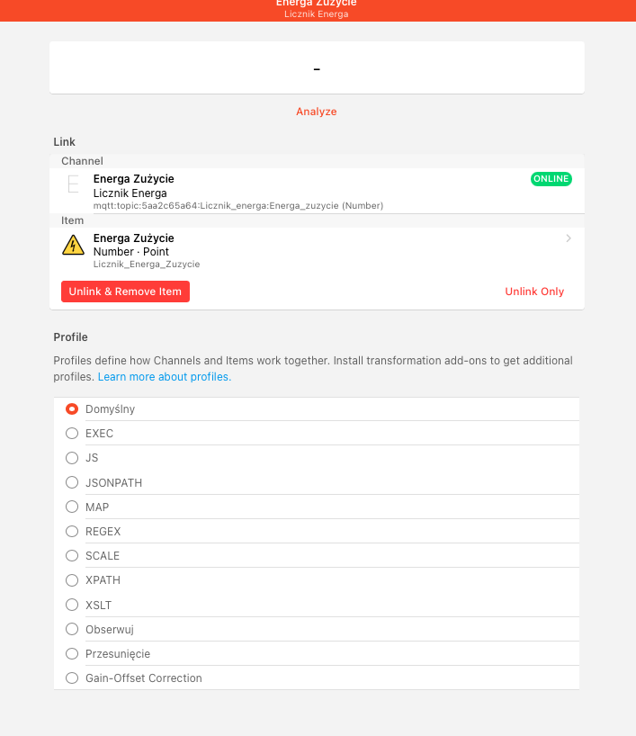

2022-03-10 14:03:33.664 [WARN ] [ofiles.JSonPathTransformationProfile] - Could not transform state '7172.23 kWh' with function '$.produced' and format '%s'
2022-03-10 14:03:33.669 [WARN ] [ofiles.JSonPathTransformationProfile] - Could not transform state '11582.656' with function '$.used' and format '%s'
Somewhere, you have applied a profile to a link(s) between a channel and an Item.
If you are doing JSONPATH transformations in the channel, you probably do not want a transformation profile as well. Set that to default.
