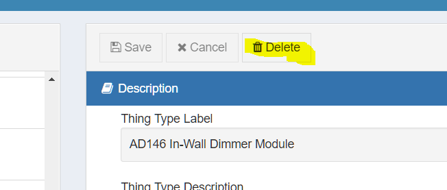

Using this button?
Yes - that’s the one…

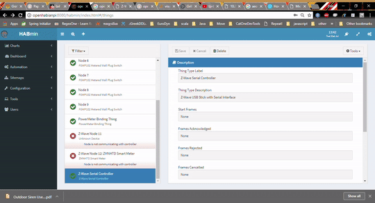

So I did everything that you say here but the device does not get removed from the controller.
Also, is it true that if the device is no longer available you have to remove it with the vendor’s utility software?

To remove a failed node, you can try using Habmin (select failed node> Tools> Advanced settings> Remove device from controller, then delete the Thing. If that does not work, you will need other software, but this should not be vendor specific. The serial API is a Z-Wave specification, so standardized across vendors. Zensys Tools can be used for this (search the forum). Aeon Labs distributes a modified version with their firmware, but I’m not sure if it includes this functionality.
