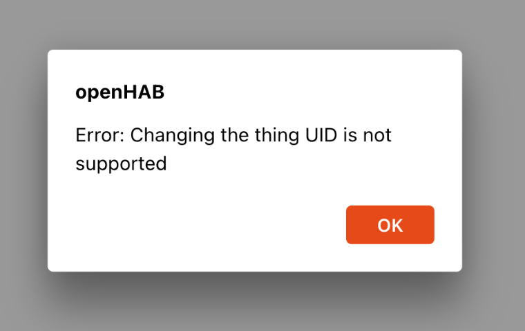

I tried the following:
  1. Add the new device as a thing
  2. Copy the code from the new device:
  3. Paste the code into the old item
Unfortunately, when I tried to save the new code, I got an error: Changing the thing UID is not supported
Is there any way of achieving what I want to do?

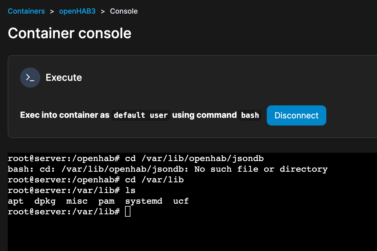

If it’s autodiscovered, it’s the job of the binding to detect and create the Channels.
That path doesn’t exist on my instance:
Is it because I’m running OH in a docker container?
Edit: I found the file in /openhab/userdata/jsondb/and replaced the new uid string with the old uid string everywhere it occurred and it seems to work now.
Thank you for your assistance!
Yes. Inside the container it’s /openhab/userdata/jsondb.
Outside the container it’s what ever folder you have mounted to /openhab/userdata.
