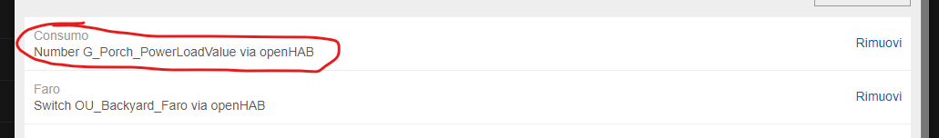

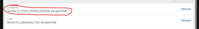

Now I have G_Porch_PowerLoadValue listed in my Alexa
but I cannot still figure out what I need to ask to Alexa to retrieve back the current numeric value (no problem if it comes without unit of measurement).
If I ask *Alexa, what is the consumo" (means consumption), Alexa answers with a off-topic wikipedia definition.
What should I ask???
