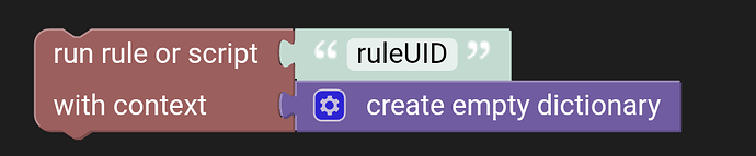

In Blockly:
There’s also a “Scenes, Scripts, & Rules” Action.
