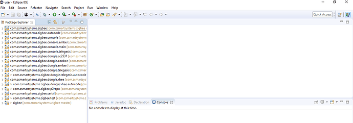

I successfully import your workspace into Eclipse IDE without any errors.
I just followed below steps:
  1. Go to file and select import option and select Maven Project.
  2. Select Existing Maven Projects and browse your workspace and click finish.
  3. Worksapce build successfully without any errors.
but here i have one doubt, how to start console application.
Above steps are perfect?.
Anything have i left in workspace to import.

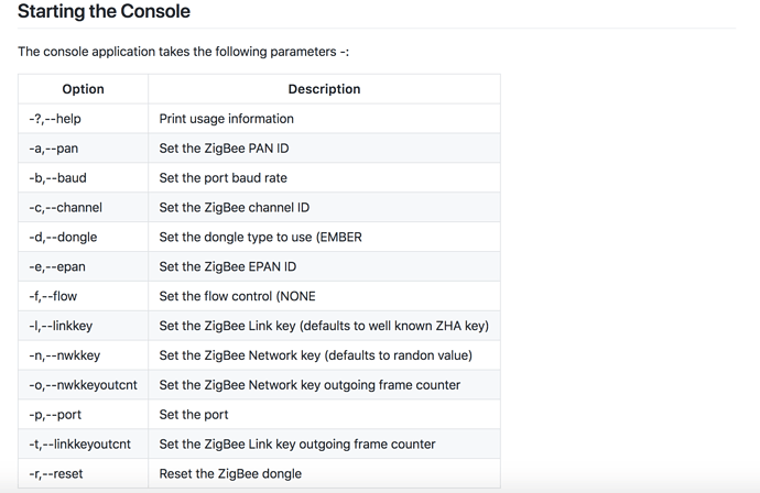

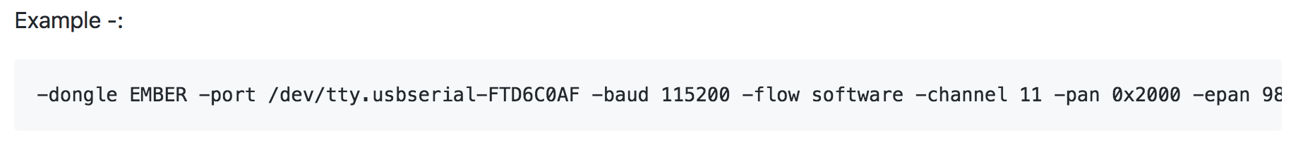

The command line arguments and an example command line are shown in the documentation -:
I hope this helps…
I understood those commands.
But i am unable to run the console application in Eclipse IDE. Below screen shot is my eclipse ide.
I don’t know how to run the console application. Where i have to run the console application in
eclipse ide. Please help me.

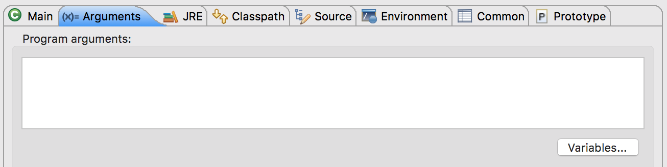

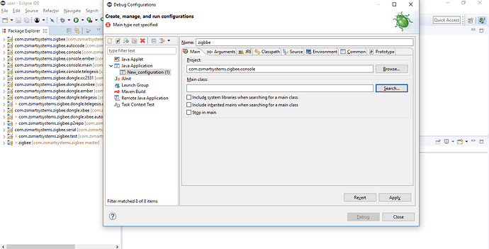

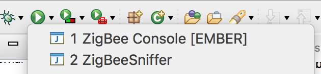

In the taskbar there is a run and debug dropdown where you can configure the start configurations.
If you are not familiar with using Eclipse, then it might be worth looking at an online tutorial to get your self familiar with the environment.

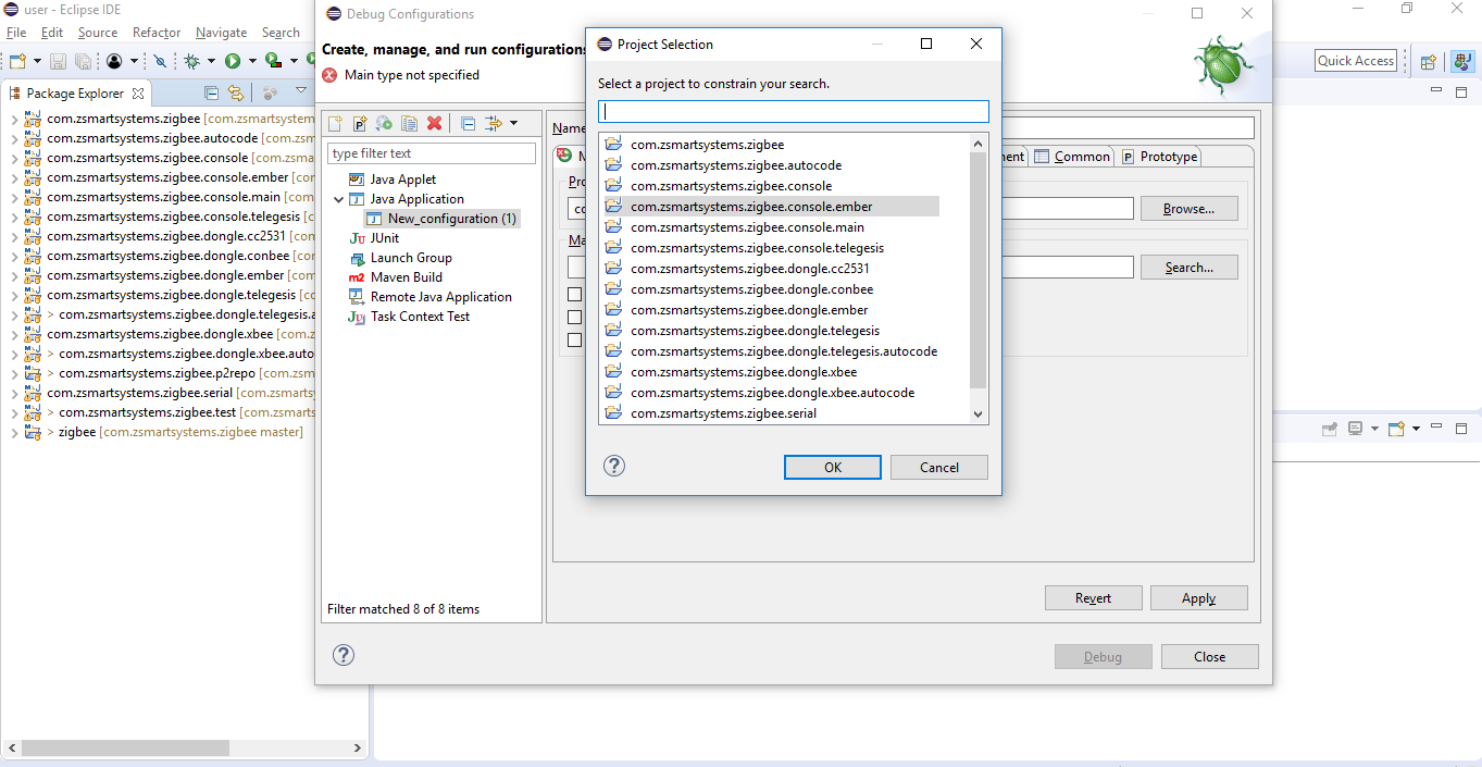

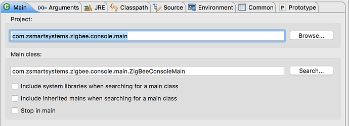

I got those options. I select the Debug Configuration. I created java application.
In that configuration, which package I have to browse. Which class i have to select to run the
Thanks chris… I configured zigbee console application.

As the error says - it is missing the required options d and p - you need to add these options to the command line.
I tried adding the option d and p in eclipse ide console. it’s not taking input values.
Is there any method to add d and p options .
Just write them on the command line arguments input area in the IDE.
Please consider looking for a tutorial on using Eclipse IDE if you are not familiar with the environment (as seems to be the case). It will make things easier for everyone - especially you.
Now i understood how to give command line inputs in eclipse ide. I tried in that. I have given input dp in program argument area.But still getting the same error.

Please see the second message above -:
Or see the readme file in the documentation that I have posted the link to!
Thanks @chris console is worked for me in eclipse ide.
I just follow below steps.
  1. This is my console command-dongle CC2531 -port COM7 -baud 115200 -flow software -channel 11 -pan 0x2000 -epan 987654321 -nwkkey AAAAAAAAAAAAAAAAAAAAAAAAAAAAAAAA -reset.
