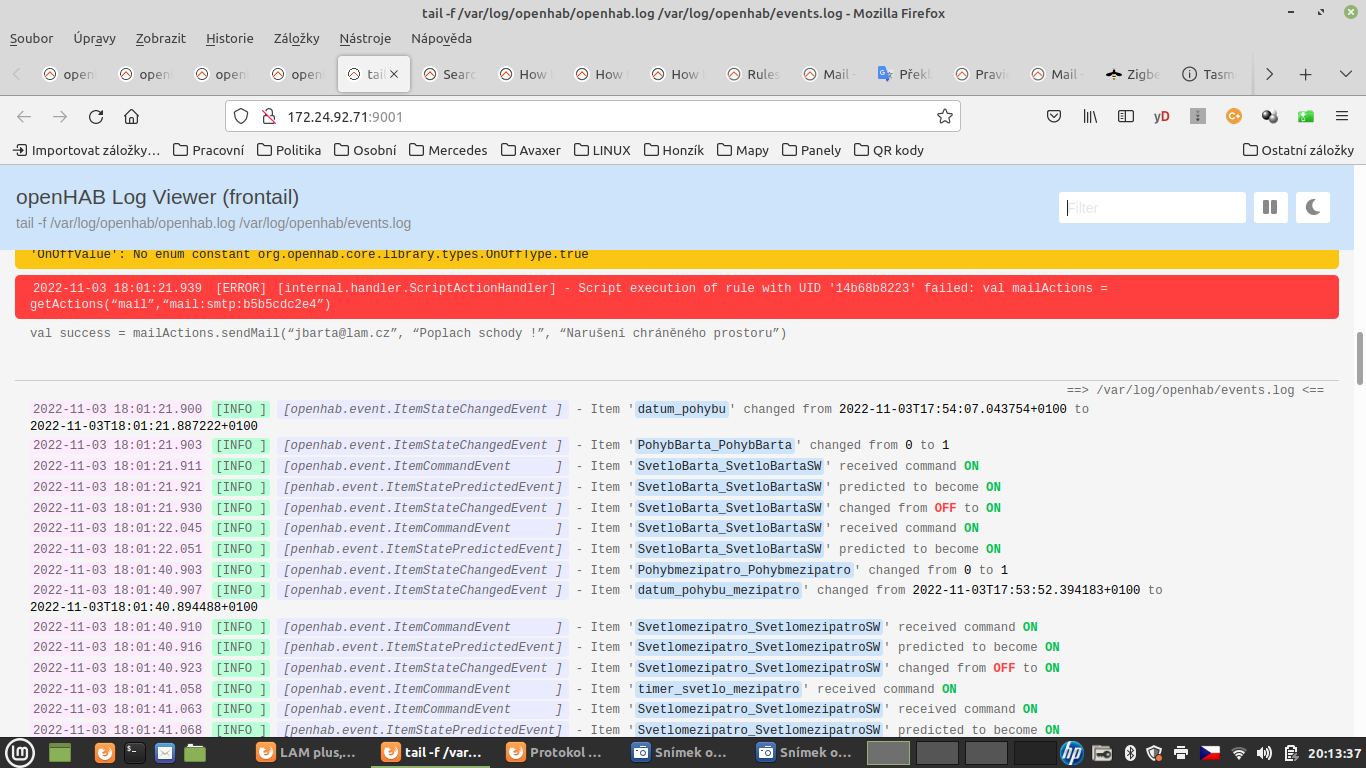

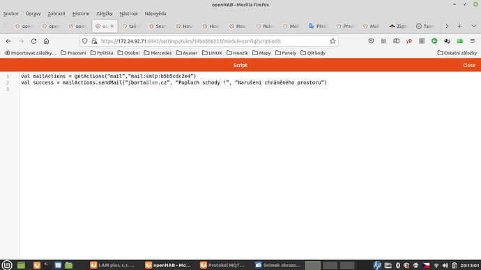

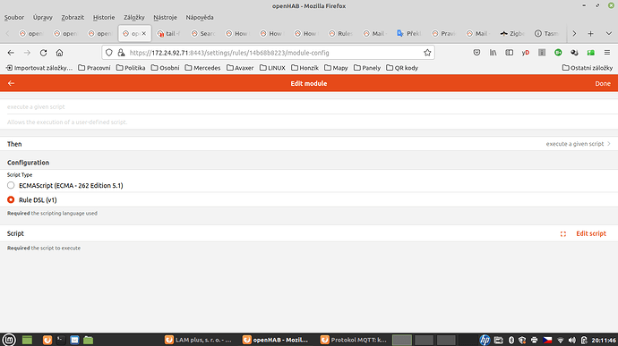

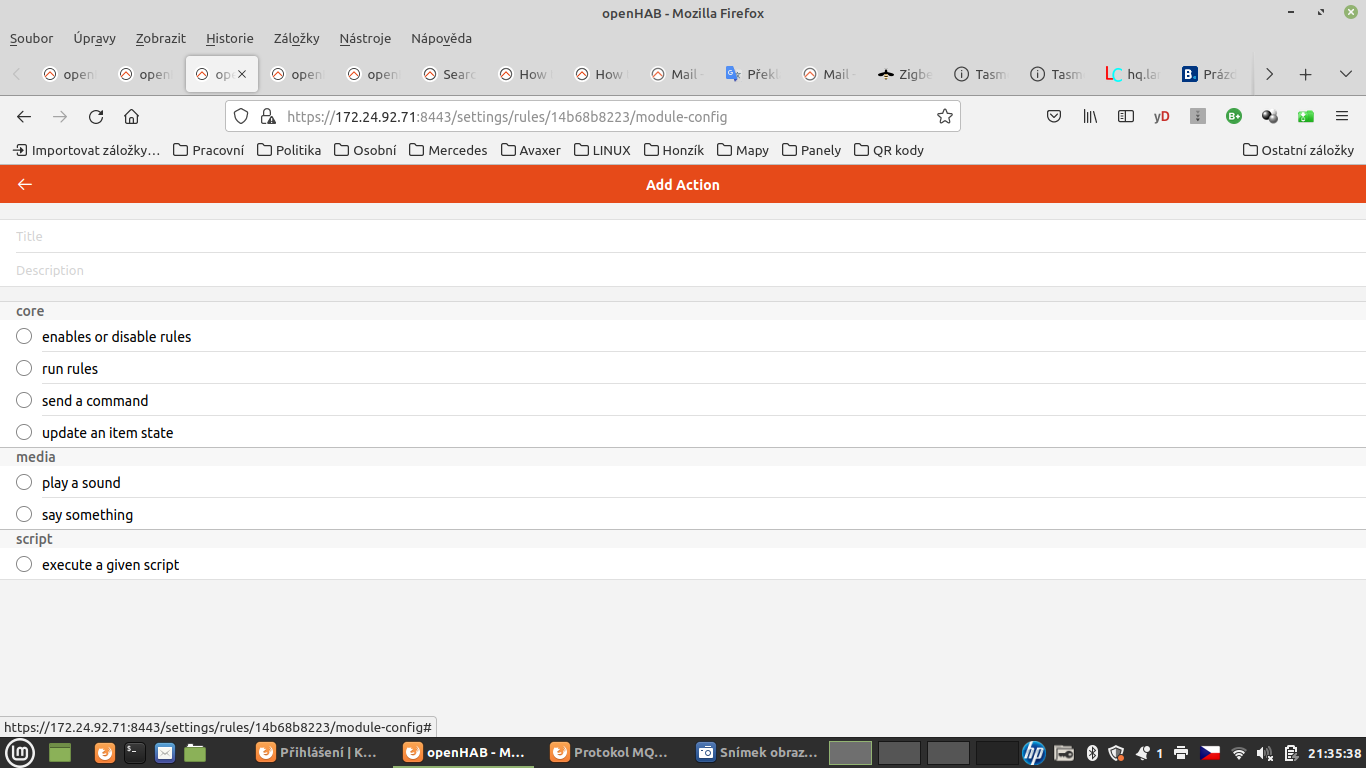

So I studied the recommended chapters. Unfortunately, they are nebulous from my point of view.
I got the impression that I could write some of the elements as a script:
But it doesn’t work - see error message
Therefore, please once again, would you find someone here who could clearly and unambiguously tell me how and where to write to make it work.
for this kindness, I deeply bow down to the benefactor in advance.
best regards Jan

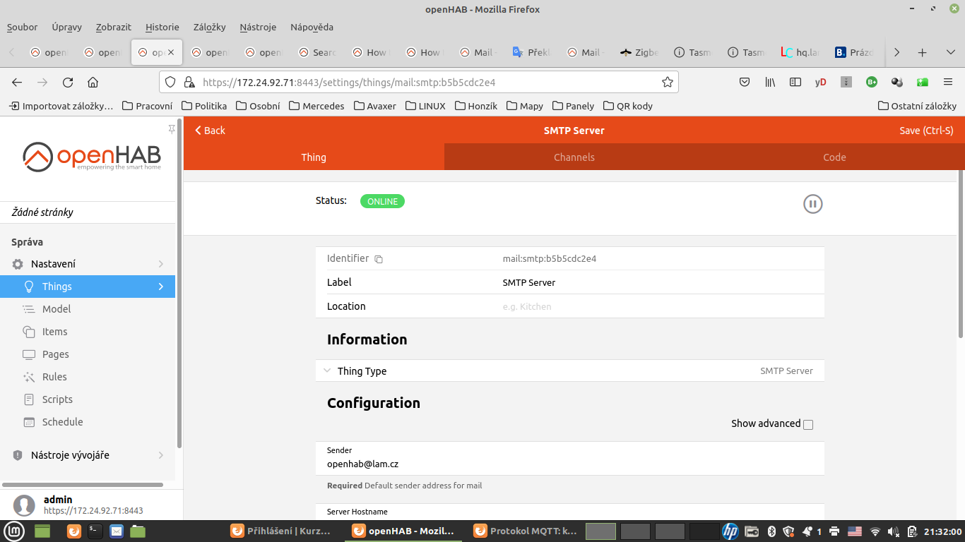

As for what’s wrong? You’ve cut off the logs and it’s really hard to read screen shots. Please paste the text into your replies using code fences:
code/logs/configs go here
Where there is a “Code” tab in the upper right, click on that and paste the text you find there instead of screen shots.
Some of the obvious problems:
there’s a typo in the thing ID in the call to getActions
the Thing is not ONLINE

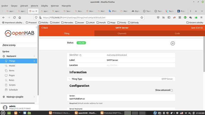

Code of thing SMTP server:
UID: mail:smtp:b5b5cdc2e4
label: SMTP Server
thingTypeUID: mail:smtp
configuration:
hostname: smtp.lam.cz
security: PLAIN
port: "25"
sender: openhab@lam.cz

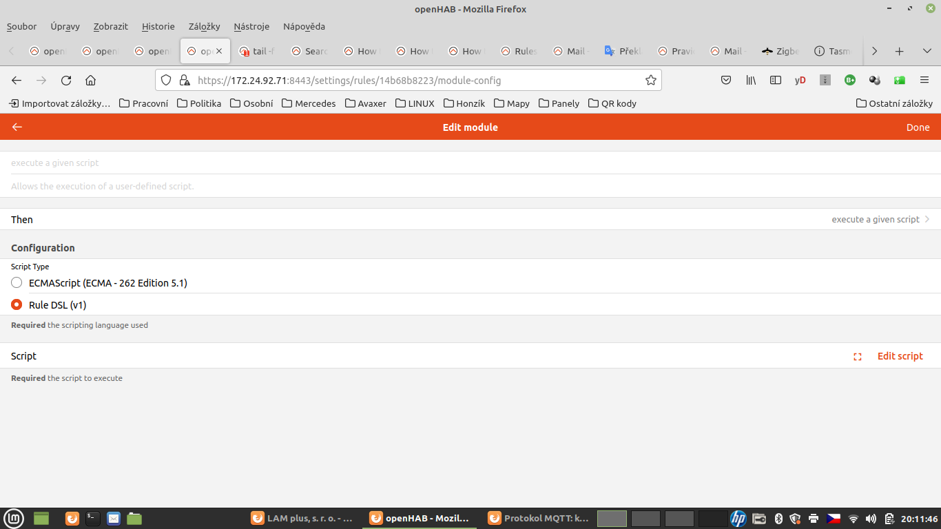

Code of rule:
configuration: {}
triggers:
- id: "1"
configuration:
itemName: PohybBarta_PohybBarta
state: "1"
previousState: "0"
conditions: []
actions:
- inputs: {}
configuration:
type: application/vnd.openhab.dsl.rule
script: >-
val mailActions = getActions(“mail”,“mail:smtp:b5b5cdc2e4”)
val success = mailActions.sendMail(“jbarta@lam.cz”, “Poplach schody !”, “Narušení chráněného prostoru”)
type: script.ScriptAction
jbarta
(Jan Barta)
November 5, 2022, 7:55am
8

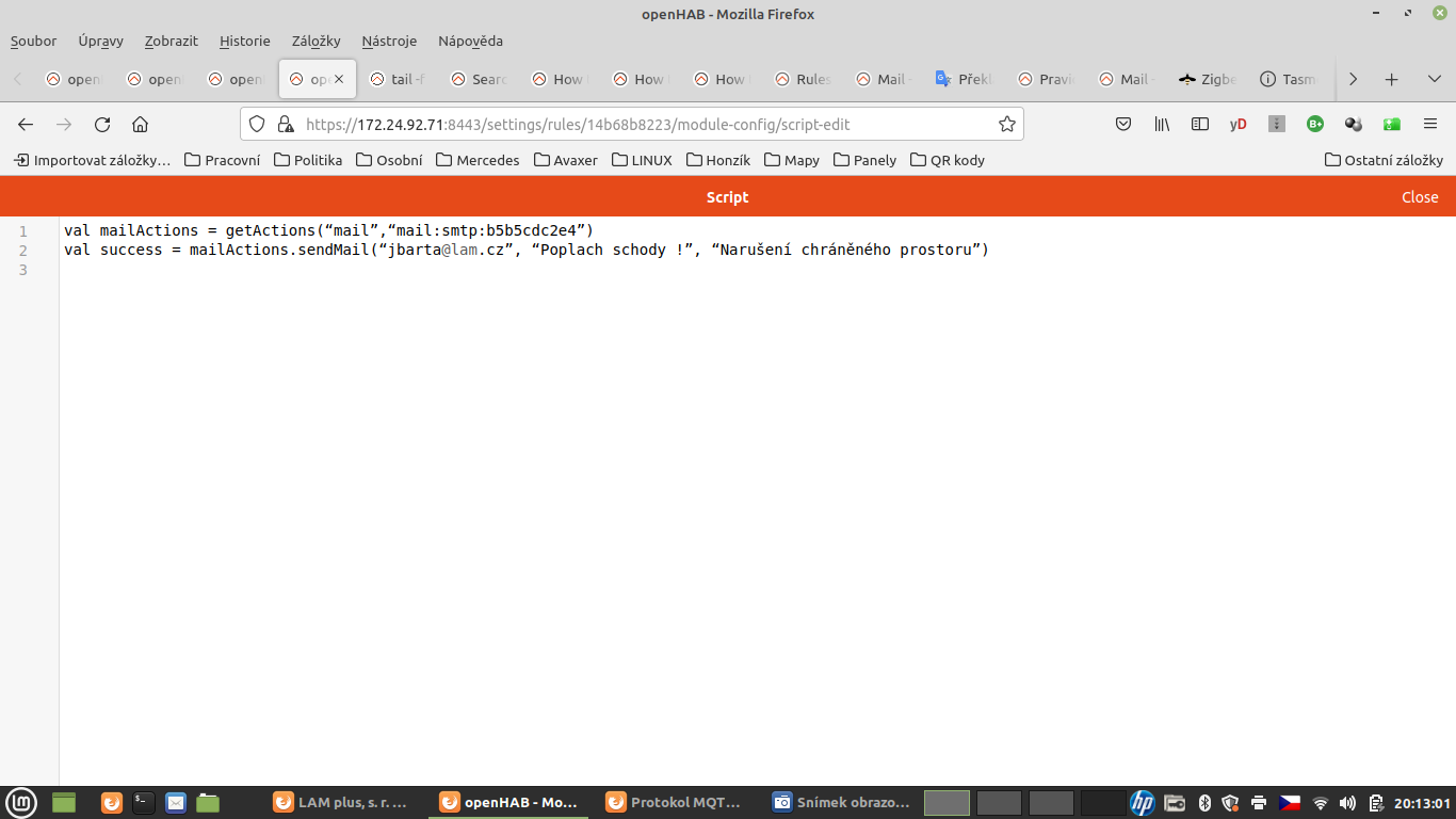

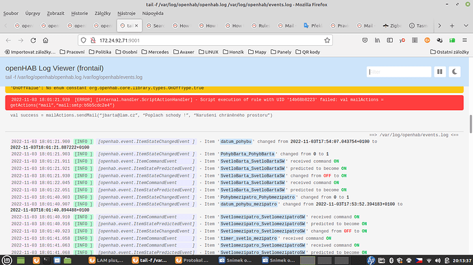

I think the problem is at a higher level. Openhab reports an error no matter how I formulate the command. When I type:
getActions("mail", "mail:smtp:lamsmtp").sendMail(“jbarta@lam.cz”, "Poplach schody !", “Narušení chráněného prostoru”)
Appears in the log:
2022-11-05 08:52:53.316 [ERROR] [internal.handler.ScriptActionHandler] - Script execution of rule with UID ‘9bcbd5b01d’ failed: getActions(“mail”, “mail:smtp:lamsmtp”).sendMail(“jbarta@lam.cz”, “Poplach schody !”, “Narušení chráněného prostoru”)
When I write it differently, it appears in the log:
2022-11-05 08:54:41.054 [ERROR] [internal.handler.ScriptActionHandler] - Script execution of rule with UID ‘14b68b8223’ failed: val mailActions = getActions(“mail”,“mail:smtp:b5b5cdc2e4”)
It seems to me that Openhab does not accept any code. Could it be a missing component in some general setting?
rossko57
(Rossko57)
November 5, 2022, 11:56am
9
I don’t know where you copy/pasted that from, and how well it represents what you actually have, but those are the “wrong” kind of quotemarks, and will break if used in a real rule.
“incorrect quotemarks”
"correct quotemarks"
jbarta
(Jan Barta)
November 5, 2022, 3:42pm
10
Yes, sir, you hit the nail on the head!!!
I copied it from the Openhab documentation and replaced it with real data - so I wouldn’t have dreamed of it…
Thank you very, very, very much for the great observation!!!
