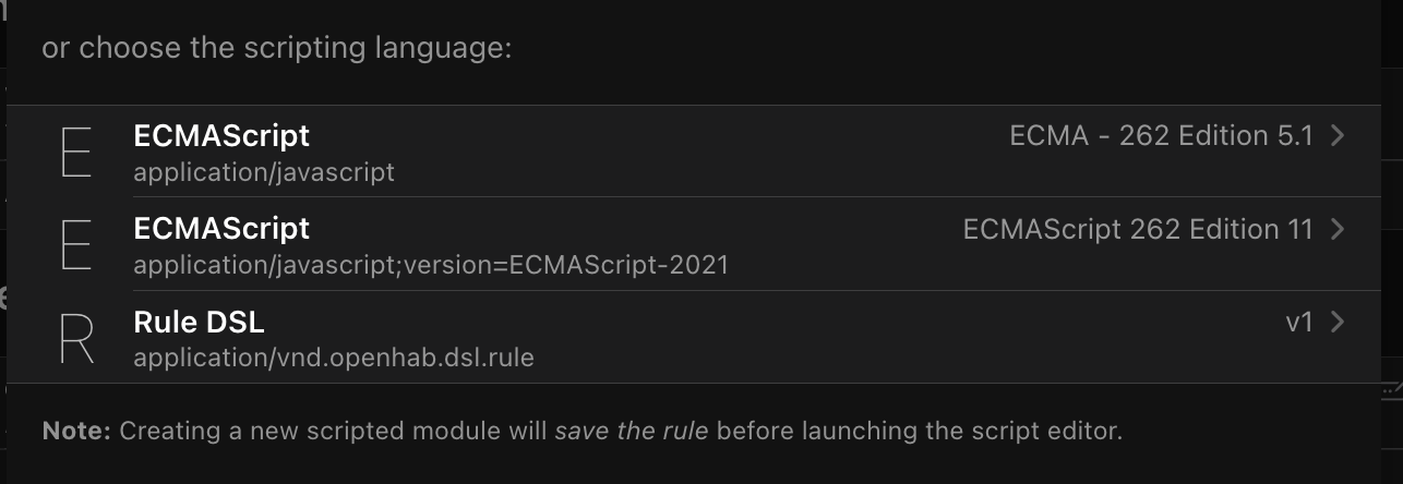

Please verify that your script is showing “application/javascript;version=ECMAScript-2021” under the “Edit Script” heading, and not simply “application/javascript” – these are two different engines with different requirements. I pop in and out of working with my rules and often find myself chasing information that applies to the wrong version of JS.
Ah! Mine just says application/javascript. Is there a command I should be using in place of actions.thingactions, or are there more differences than that?
When you add the script to your rule, you select the engine you want to use to process it. The options available will depend on the rules engines you’ve installed; here’s mine:
In this case, the second ECMAScript (Edition 11) was used. If it’s not available for you, you’ll need to go to Settings → Add-ons → Automation and install the JSScripting option.
