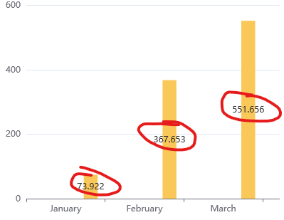

Is it possible to set a fixed number of decimal places for the label in a bar chart (echart)?
I found a way for the “markLine” (series-bar.markLine.precision ), but I didn’t figure out a possibility for the label itself. I want to get rid of the decimal places in my bar chart.

IMHO this should work, at least in latest snapshots …
formatter: =v=>v.toFixed(2)
Did try only on a gauge, but probably should work for all …
EDIT: syntax for bar is a bit different:
label:
  show: true
  formatter: =v=>Number.parseFloat(v.data[1]).toFixed(1)
this did the trick for me
or with toFixed(3):
