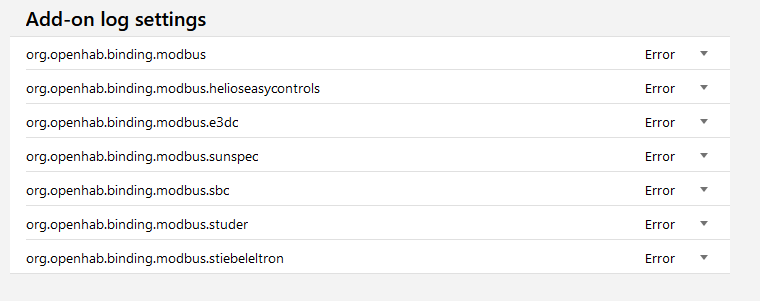

But this is not available. When I call “log:list” I only see:
org.openhab.binding.modbus │ ERROR
org.openhab.binding.modbus.e3dc │ ERROR
org.openhab.binding.modbus.studer │ ERROR
Also in the binding configuration it is not available:

Do you know how this can be added to the Modbus Configuration page? Do I need to write an issue for this?
STSC:
hmerk
(Hans-Jörg Merk)
November 12, 2023, 6:48pm
13
You cannot, as this belongs to the core io bundle, which is used in all the different modbus bindings.
