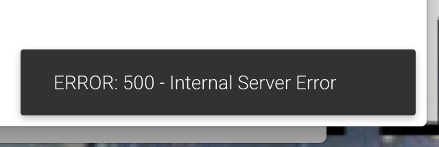

  2. When I tried to configure the sensor detected as zwave thing through Paper UI for test purposes, I found that it does not update but the browser receives a small, black notification box in the bottom right showing a “HTTP 500: Server Error” and the properties get not updated …
Hence I prefer setting this via config file but do not know how?

When I alter the properties of the sensor via Paper UI, I get this message in the browser and the changes are not done:
This error means that the device is not part of the network and it’s unknown by the controller and needs to be re-included.

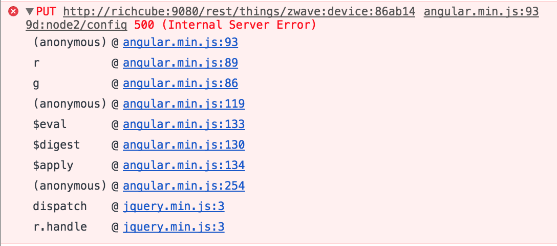

This is the error details of HTTP 500 from the Chrome Browser console:
So even when the node2 is ONLINE, the Paper UI update fails …
found a corresponding entry in openhab.log:
13:40:04.976 [ERROR] [est.core.internal.thing.ThingResource] - Exception during HTTP PUT request for update config at 'things/zwave:device:abcd1234:node2/config' for thing 'zwave:device:abcd1234:node2': null
As said above, if you are defining your things through text files, you can’t use PaperUI to configure them.
Ok will mount userdata from outside the container to keep data and then I will reconfigure zwave completely through Paper UI …
I removed the Zwave.things and items file and reconfigured Z-wave USB Controller and the Devolo device via Paper UI but I got still the same HTTP 500 Error with the same PUT error in the Google Chrome console log.
I found in the forum that there have been others struggeling with Paper UI and such type of error and that it works with habmin … I will activate it and try it via habmin!
It works with habmin!!! ??? So, I am wondering what’s wrong with the Paper UI …
Have now parameters set via habmin …
