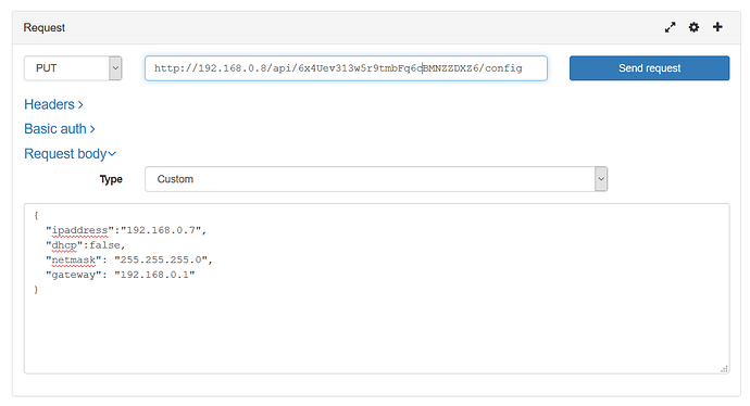

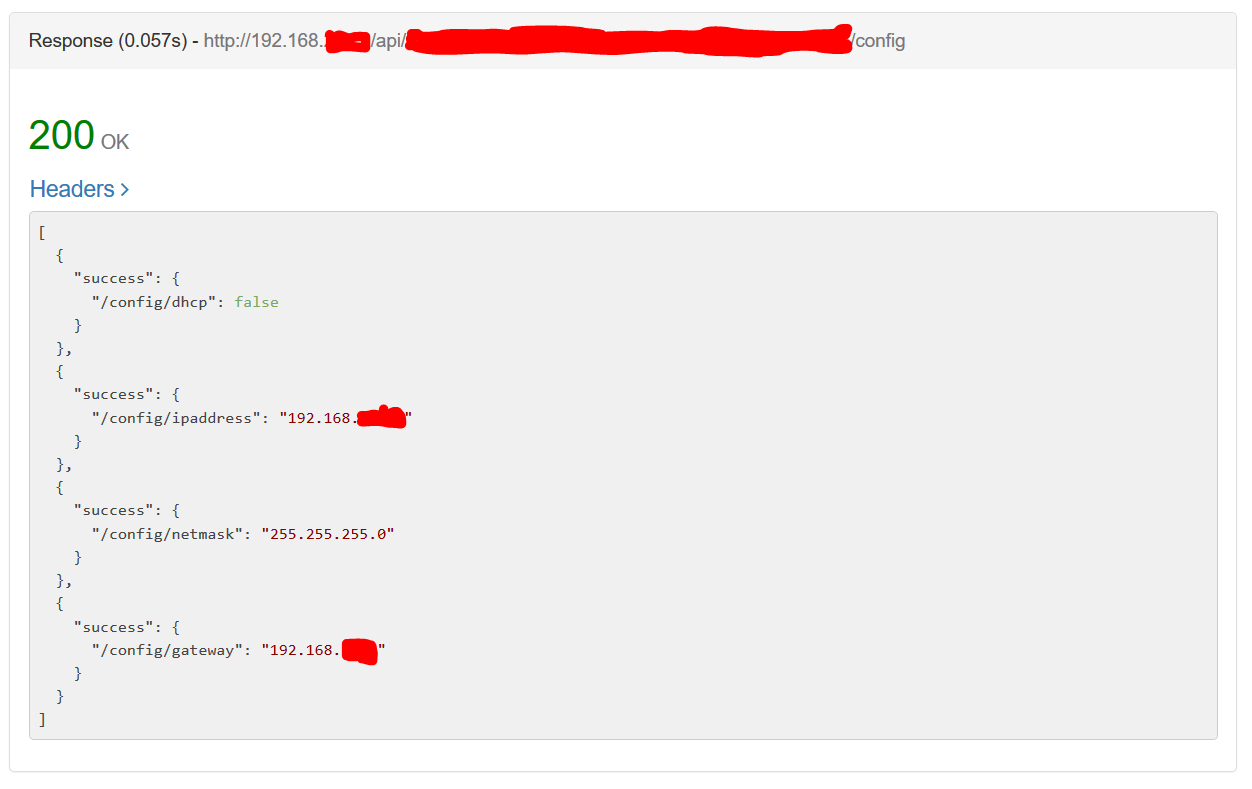

Get yourself a tool similar to https://addons.mozilla.org/en-US/firefox/addon/rested/ so you can send REST requests to the bridge.
  • As action, use PUT
  • As URL, use http://[bridge-ip]/api/[bridge-user]/config
  • As body:
    { "ipaddress":"[new-ip]", "dhcp":false, "netmask": "[network-netmask]", "gateway": "[network-gateway]" }
    For example:
    { "ipaddress":"192.168.0.7", "dhcp":false, "netmask": "255.255.255.0", "gateway": "192.168.0.1" }
