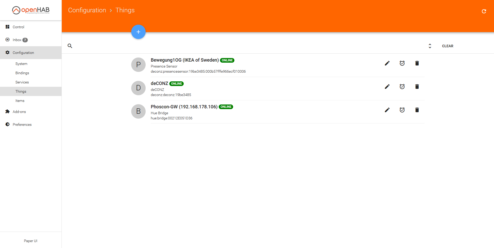

Screenshot_2020-01-16 Paper UI
Here are is apicture:
As i can see, deconz is up and running fine on openHab.. At least, IKEA sensor was discovered. What exactly doesn’t work? deConz thing from your screen is not a device - it’s just a bridge, which allows to connect devices to openHab, it’s not a, let’s say, real sensor or device. If you need to add a new device - make sure that you added it to deConz app first, and then it will appear in your inbox in openHab.

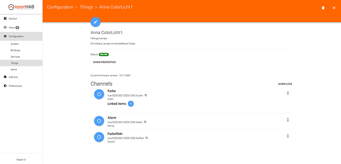

I get it now but I have some other problems:
I have a Phillips Color Light but I only see this:
and no option to turn it on or off. I tested it also in ioBroker and there you can see a special Object for turning the light off and on.
You’ll need the HUE binding for lights. The deConz binding is only for sensors. See
deCONZ also acts as a HUE bridge. This binding is meant to be used together with the HUE binding which makes the lights and plugs available.
As i can see from previous post, HUE bridge is installed - see screen from mor_2003 3 posts before, Phoscon-GW thing is a HUE Bridge.
The problem was discussed a few time before on the forum and mostly is related to problem with missing switch channel. An item with type switch must be created manually and mapped to color channel .
@mor_2003, check, please, the solution in hue binding documentation
Or here [SOLVED] Setting up HUE lights for dimmer AND ON/Off switch - #4 by Kim_Andersen
