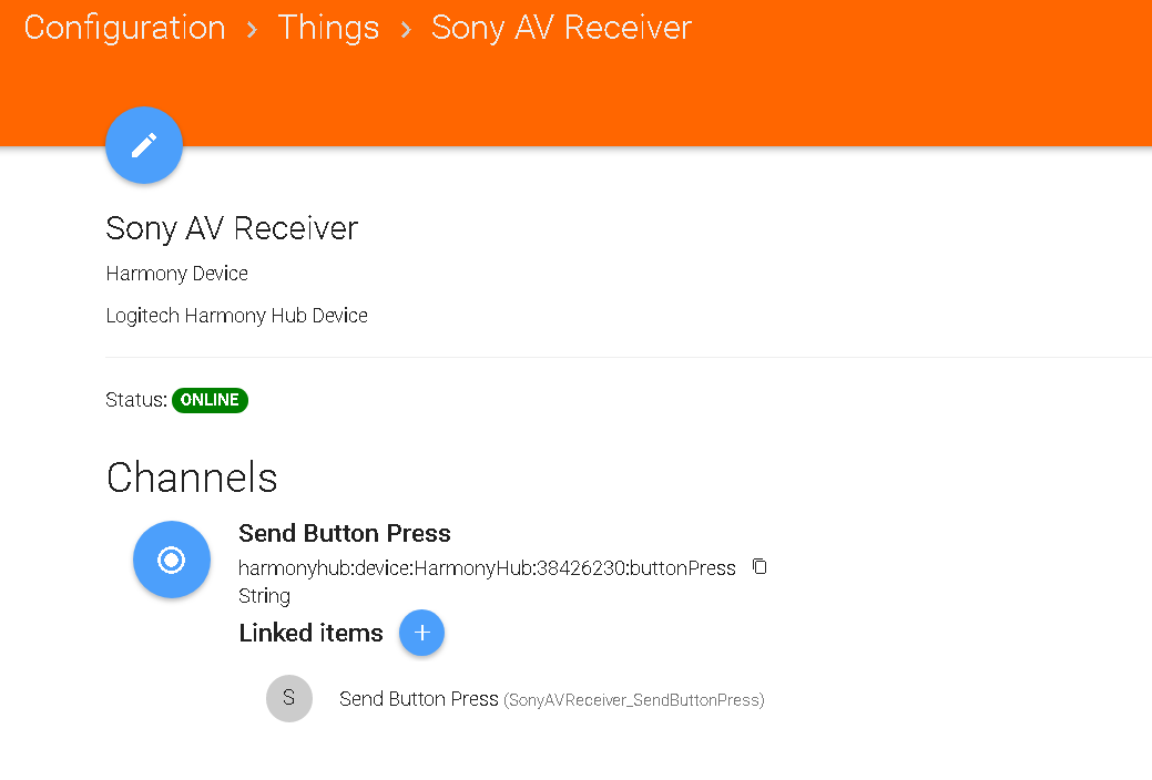

  • Issue of the topic: I am trying to set up rule my Sony AV Receiver. I added the receiver Thing using the Harmony Hub Binding. I linked a SonyAVReceiver_SendButtonPress Item to the harmonyhub:device:HarmonyHub:38426230:buttonPress channel. I can now power on/off the receiver in the Paper UI Control so I know I have that part working. Now I want to create a rule so when the receiver is turned on, my Echo Dot connects to the Bluetooth interface on the stereo.
    I’ve tried using rules based on the channel and based on the Item. The Channel based rule does not work at all. The Item based rule almost works. It runs when I change the Sony Receiver power using the Paper UI. But I’m not getting the value of the button press (PowerOn vs PowerOff) correctly in my rule. How can I write the button press value to the openhab log so I can troubleshoot? Or is SonyAVReceiver_SendButtonPress.state the wrong attribute?
