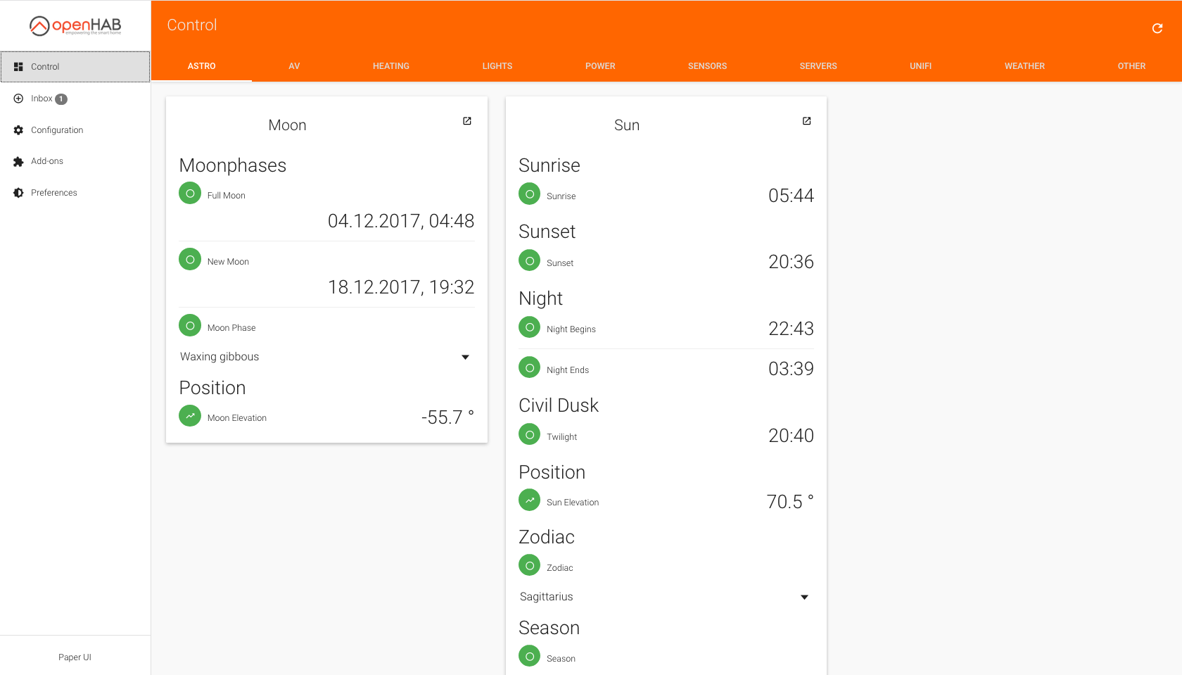

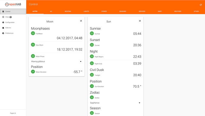

You can also take things further if you DESPERATELY want to see the things clearer in PaperUI.
Bridge hue:bridge:1 "Hue Controller" @ "Hue" [ ipAddress="192.168.X.X", userName="XXX" ] {
    0200 1 bulb1  "Bulb 1" @ "Hue" [ lightId="1" ]
The text in quotes is used to determine the tab the things are shown on.
