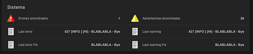

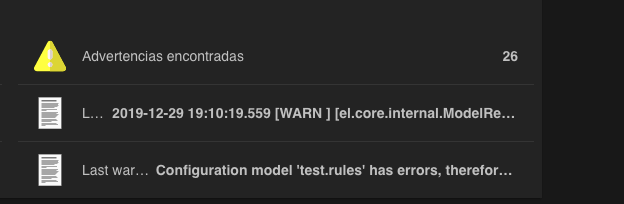

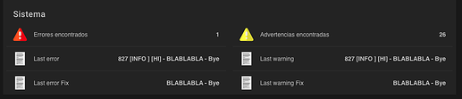

And the results:
Real case:
And that’s it. It may not be the final solution to the problem of long text but at least it allows you to see where the problem is with better definition than before.
