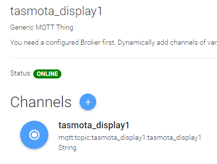

Hi. after some help please.
I have mqtt working successfully between openhab, the mosquitto broker & a network enabled display. I want the sitemap to provide information as to what is happening with the display. I thought this would be configured in the thing entry in the sitemap rather than as a rule, but just haven’t been able to find the info..
the aim is that when an MQTT command is sent to the display, i would like it to show in the sitemap too, if the display responds with a state, then i would like that also presented in the sitemap. (like a centralised copy of what the display is doing).
before asking, i read the openhab mqtt documents, googled here and other forums and while it’s been really helpful, aside from confusing legacy v1 documents I still can’t find the answer..
Any suggestions would be welcome - thanks.

mosquitto broker & openhab 2.5.1 running on ubuntu 20.04 in a virtual machine, an ESP8266 Nodemcu with OLED1306 display running tasmota 8.2.0.6 (display variant). Paperui used for all the config except sitemaps.

Tasmota display config
MQTT Host - openhab
MQTT Port - 1883
MQTT User- *****
MQTT Topic - tasmota_display1
Mosquitto broker
command to display hello on the remote screen from the broker using the configured thing / channel in openhab
username & password enabled
hosted on same server as openhab2
mosquitto_pub -h 127.0.0.1 -u **** -P **** -t cmnd/tasmotas/displaytext -m hello

Looks like you have Simple Mode turned on. If so than the name of your Item is actually mqtt_topic_tasmota_display1_tasmota_display1.
I recommend turning off Simple Mode so you have some control over the Items.
I do (did) have it turned on, thanks. i’ll give that a try.
If that is two different things (small t) that you want to display on your sitemap, you will need two different Items, one for “out” and one for “in”.
