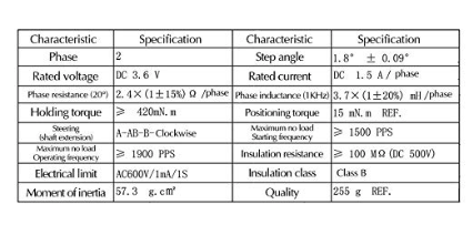

If I see a chart like this:
Which field is the angular velocity? I have a step angle but that only tells me how far it moves per step, not the velocity.

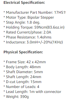

Or this chart:
which doesn’t including positioning torque. How do I know it can hold up the shade?
Or should I not be relying on the motor to hold up the shade and need some other mechanism to keep it in place?
