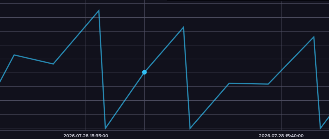

Then there is a zendure solarflow 800 configured to send to the above mqtt server OH reads the messages from there.
There is a small issue with zero (or NULL?) values getting read between the actual data messages.

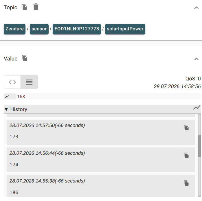

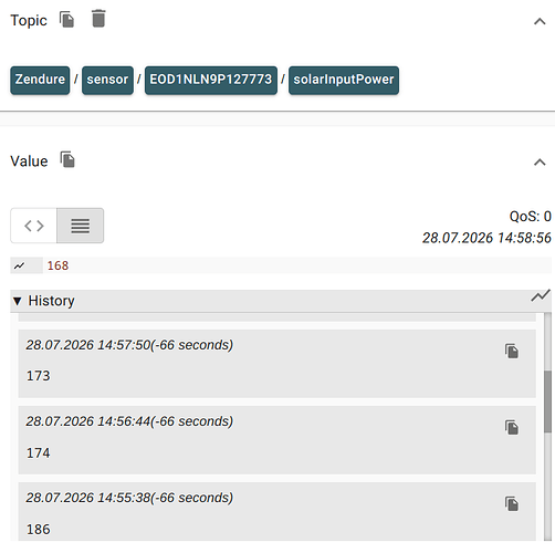

The client is sending (observed via MQTT Explorer)
One message every 66 seconds.

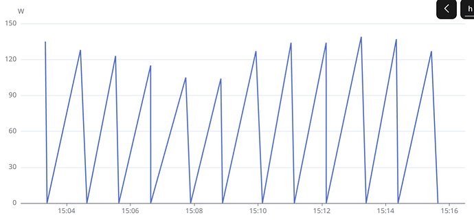

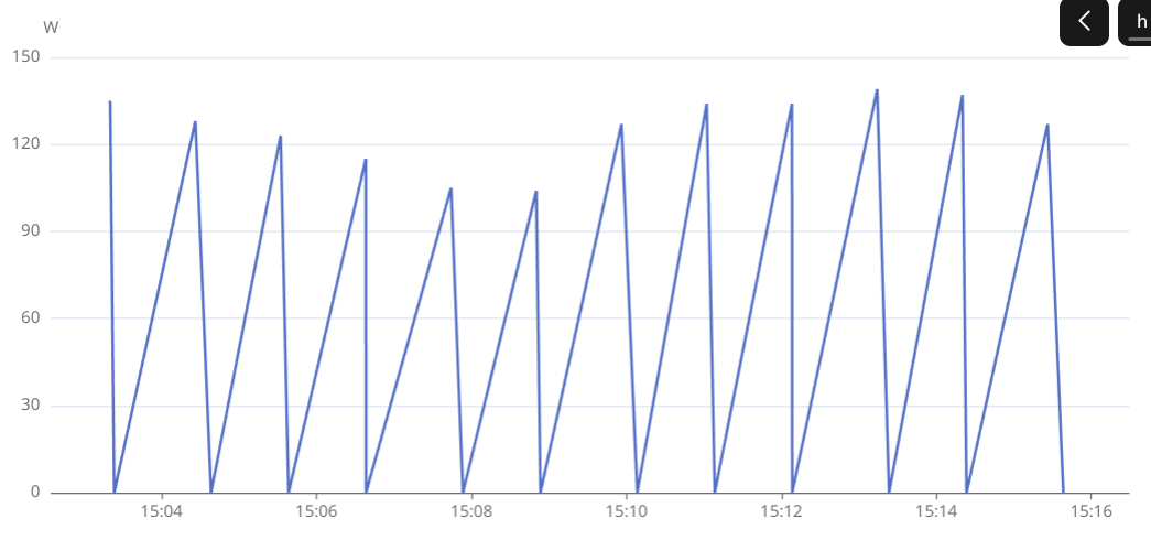

OH reads a zero few seconds after each actual measurement, like

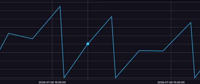

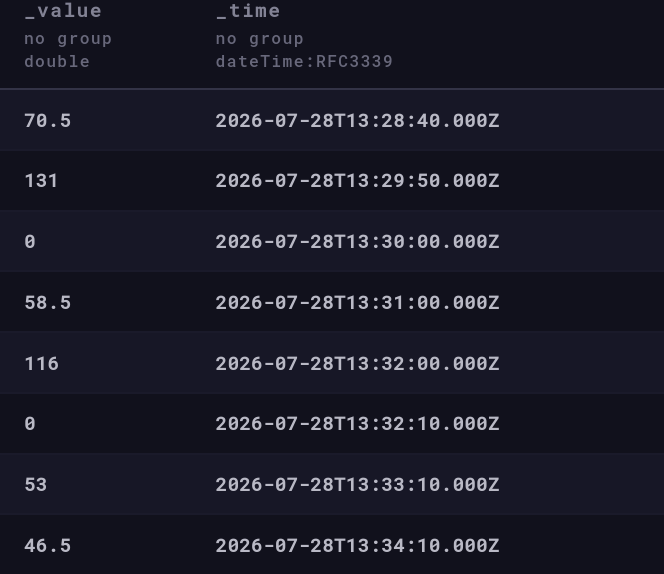

Looking at the actual data in database there are even more “in-between” values
But OTOH, there are mqtt channels from the zendure device where values change only after some minutes and there I do not get those zeros.
Is MQTT Explorer not showing the real data on the channel? Is OpenHab pulling data out of thin air? What is going on here?
How could I get rid of those zeroes?
