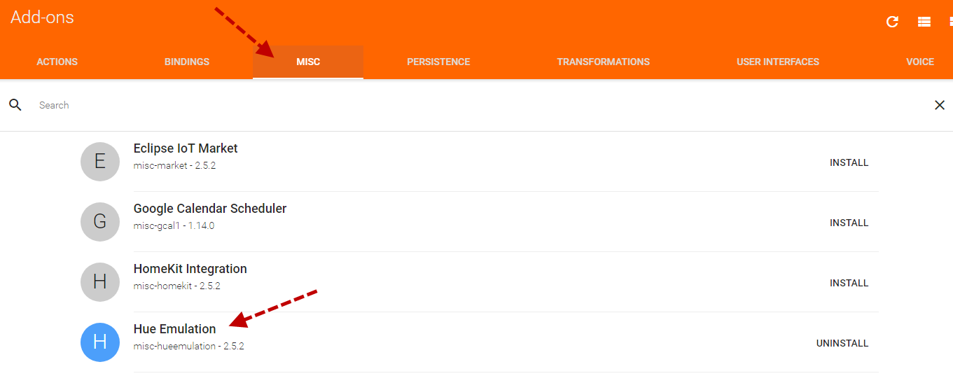

The Hue Emulation service acts like a hue hub which allows you to control OpenHab items that are tagged correctly. I own 0 Hue devices, yet I use the emulation to control lights, Christmas trees, Garage Doors, Driveway Gates, Pool Pumps, Waterslides, etc via Alexa and the Hue Emulation.

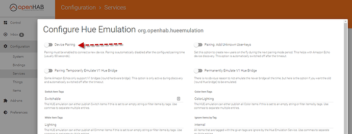

Reading the documentation it is stating that it must be put in pairing mode - How to perform this, is it like the ZWAVE pairing function?
And in your example you are using [ “Switchable” ] and in the documentation it says this is specifically for OSRAM SMART, “Lighting” would define a switch, are you using an OSRAM SMART here?
Further you are using the follwing instructions for your item example
And turn in Device Paring…then you ask Alexa to discover new devices…I think you can do this via the CLI…look in the docs.
