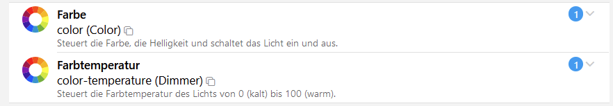

OK, found the following channels:
grafik
I also added a new item
Dimmer			OG_Arbeitszimmer_Licht1_ColorTemp					"Hue 1 Farbtemperatur"												(OG_Arbeitszimmer)			{ channel="hue:device:hb1:azLichtFenster:color-temperature" }
When I change the color temperature, i can see the changes in the hue app. But because the light does not support the color temperature, it has no effect on the light.
But it still does not switch into “ct” (=white) mode. It stays in “xy” (colormode property from local hue api). When i set the light in ct mode with the hue app, it stays there, unless i change the color via color channel. The other channels have no effect in ct mode.

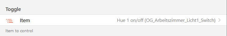

Not fully solved. I tried the on/off switch and it works in the BasicUI. At least the control is working. If I switch it on via BasicUI and then switch it off via hue app, the status in the BasicUI does not update. It still shows on.
In MainUI the switch does not work at all.
grafik
Any ideas?
Strange behaviour. Now everything works. I did not change any configuration…
