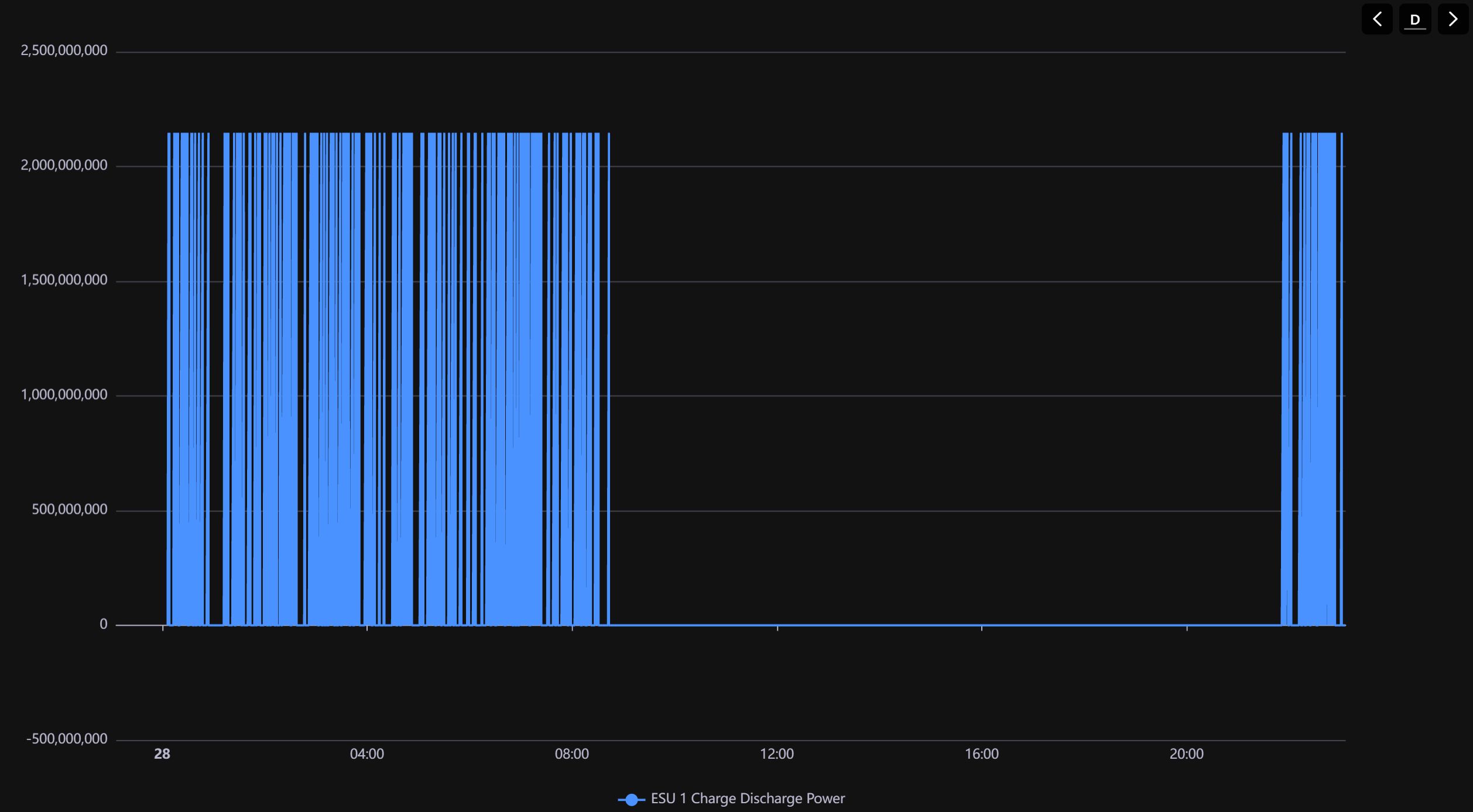

Whenever the battery is offline (e.g. at night), the charge/discharge register alters between “0” and “2147483647”. In Grafana, I can force visualization to convert the maxed INT32 value to “0” for display purposes. This does not however cure the problem in the database where these values make it impossible to use the alternating modbus output for any sensible calculations.
