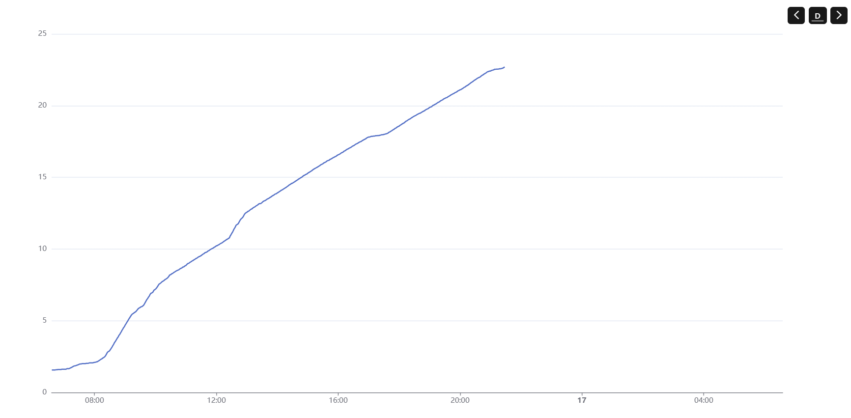

Value increase every day and during midnight is reset :
problem is, that I did some changes in the persistance configuration and there a day where part of data is missing :
Rule I’m using for complete consumption calculation for actual month. So I’m making sum of values from each day at 23:59:58 :
