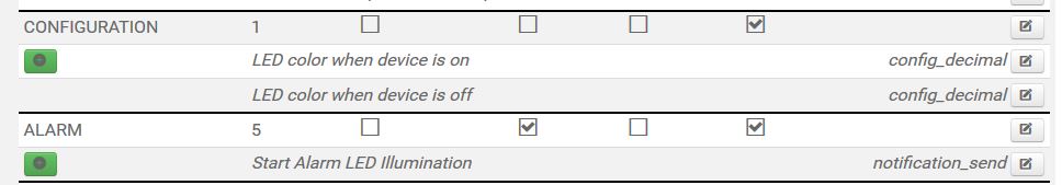

You need to find your specific Fibaro Wall Plug device (firmware version) in the database, then look for any available ALARM channels like in this example:

For some devices (on special request), those channels have been made available because those don’t exist by default.
Not sure I understand your point. Channels are there to send alarms from the plug into the ZWave network.

By sending a number to the notification_send channel you can start the alarm illumination on the LED ring on the FGWP, for example in a rule triggering if the door opens.
