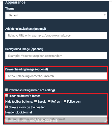

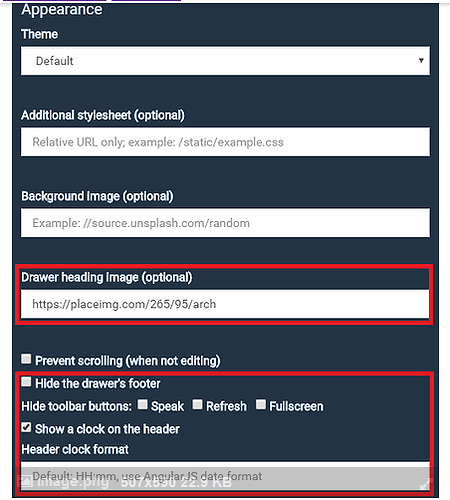

I actually did the step above, but the settings tab still looks “old” and I do not see this:
If I don’t run it with /static, it seems to be ok
However, I want to use my custom icons in /static…
