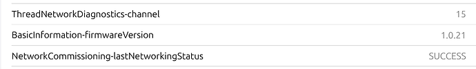

Step 11: Verify the new firmware version
After the device reboots and rejoins cleanly, read the version again:
cd ~/connectedhomeip
./out/debug/chip-tool basicinformation read software-version 0xf29 0
./out/debug/chip-tool basicinformation read software-version-string 0xf29 0
If the update succeeded, these values should now reflect the newer firmware.

As of OH 5.2.0.M2 matter firmware update is available in the thing GUI for matter devices.
